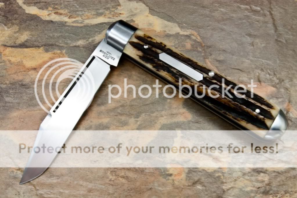

Here's a couple great looking examples of long pulls from Northfield GEC and Schatt & Morgan.
High on the spine, evenly spaced between swedge and tang, deep, attractive and useful.
