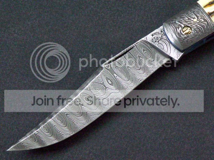

I did one once with a dremel & I think it was a 1/32" thick cutting wheel. It looked/worked great . . . until I tried to extend it later to be a long pull, which - since I tried to freehand it - produced a sloppy result.

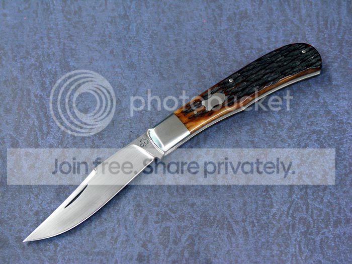

I chucked it up in my drill press, clamped the blade in a vise on my X-Y table and ground the nick in. You could also hold the blade in a vise and pull it into the spinning cutoff discs.
I used it on the knife pictured. The advantage is that you can cut the nick before or after heat treat.
Chuck and Don, thanks for the pics. They prove it can be done well with minimal tooling. All I need to do now is find a method I like and practice. Thanks again everybody.
