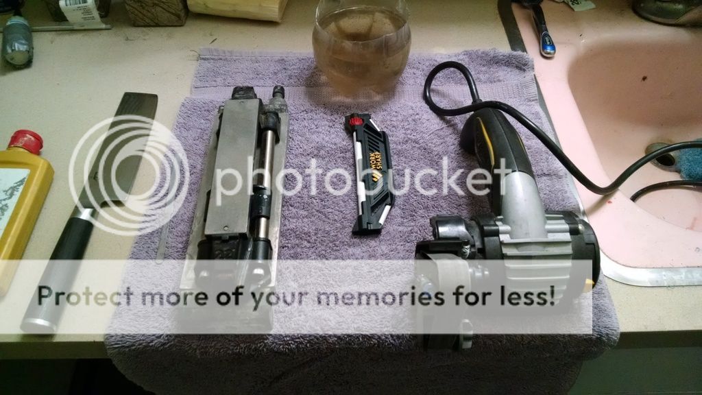

A friend/co-worker contacted me and shared her troubles.
Her husband had used her Shun VG10 Nakiri to chop some Turkey bones, haha Oops!
Whoa!
In his defense,
I can understand where he was coming from.
The Shun Nakiri is super sharp and it looks like a cleaver.
Haha but it is certainly not a cleaver
Here's my response.
It took about 10 minutes freehand on the worksharp.
It never got warm.
Afterwards , I finished out the grind on a coarse 320 diamond plate on the worksharp GSS
Lastly
Finished on a 3k Suehiro stone then a loaded leather strop
Ready for the kitchen
In the end, it was very convenient being able to use each tool.
Belts for gross removal, diamonds to set the bevel even, waterstones to sharpen and polish, and a strop for a razor sharp finish.
Four steps total.
It's not often an addiction helps a friend :)

But The shuns comes with very very thin grind which is why the performance is so amazing.
Bones are a no no with any knife that's super thin and hard and its not what a Nakiri by any brand is ever used for
Something could be amiss with it's heat treat.
The chips are spherical not square
It also grinded well, took a great edge and displays no damage chopping carrots fast and hard on a cutting board.

Nice repair! I would recommend a higher finish with most Nakiri's but for a Shun that's a good stopping point.
Jason, Awe , so a Nakiri would benefit more from a higher finish?
Nice.
I stroped it with a 1 micron and .5 micron cbn to really make the edge slide through those veggies.

Most of the time I finish at 8K or 10K but the steel needs to be hard. A stropped 3K edge would be fine on that knife, the steel is not very hard.
