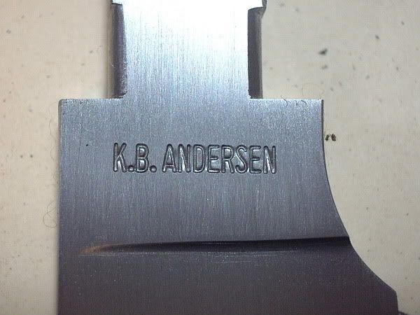

With the slight bit of interest here lately on acquiring/making stamps and holders and how to correctly use one, I thought I might share what I have learned.
#1.) Don't use a hammer.
#2.) Make a press.
I spent a few years chasing my name stamp all over my blades and getting repeated double stamps, that I knew there had to be an easier way.
Even the arbor presses and alternative "stuff" just didn't work for me.
Hence, the following.
Pretty simple.
Get some scrap steel! What I have here is waaaaaaaaaaaayy over-kill, and can be done with much less stout steel. It just so happens that it's what I had available. What is here, however, could be acquired with little effort, and the control makes any expense worthwhile!!
I milled a slot out of a chunk of steel to accept the tang and keep it rigid.
Tapped and bolted on a face plate and a cap on the top.
Easy.
Set the blade on the top of the bottle jack and simply press the stamp into the blade!
You can even turn the stamp 90 degrees to stamp along the direction of the spine if you like.
Perfect EVERYTIME!!

GREAT looking mark(s) Karl !! (rutrow, I see the makings of a future funny there :D ;) )
Anyway...... :) that's one of the sharpest, cleanest marks I've seen. Thanks for sharing your secret :thumbup: Would you mind sharing the manufacturer of your stamp too ;) ?
I've had that for over 10 years - I forget where I got it. But I do remember that it was one of the two big makers at the time like Henry Evers or Harper Manufacturing.
It's not a matter of the stamp - I think it's a matter of application.

Steve, I think that picture sort of speaks for itself. Once I finish out the knife, the stamp looks like it's cut in with a laser!
And, that's a 20 ton jack, but I don't use near the total capacity. I'm sure a small 10 ton would work just fine.
Also, Stan there, says Harbor Frieght has one for 99 bucks. You can get a 20 ton jack online for about $19.99. It's worth going to a welding shop and have a small frame welded up if you can't weld one yourself. I say that for the guys who may not have a welder.

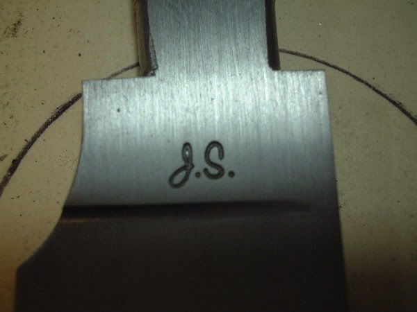

I've been doing mine cold and with hammer for years but the size and shape of my stamp helps. The press is definitely a better way to go.
