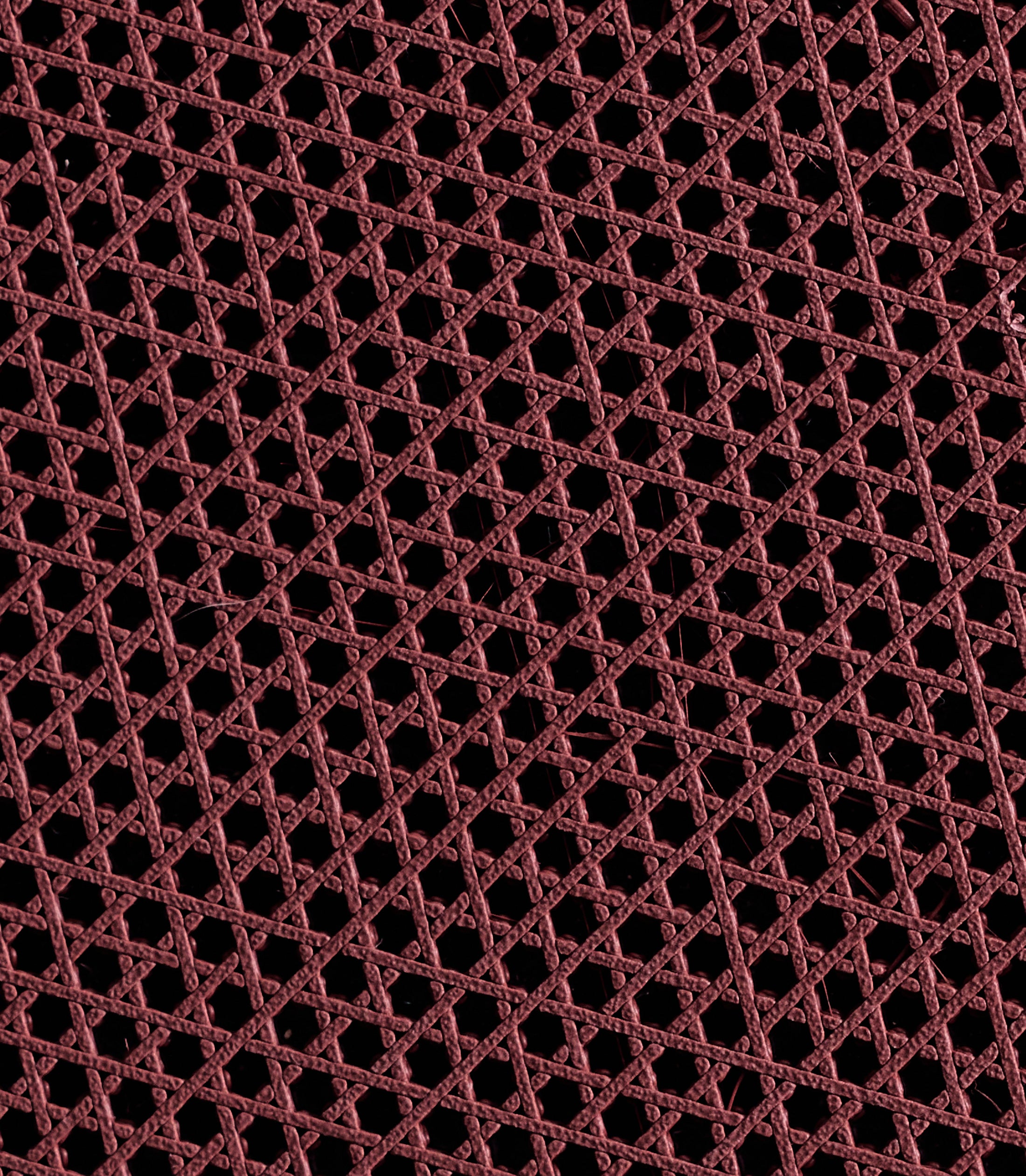

I have never seen a sharpening surface like this before. Has anyone tried one? Is this a gimmick or does it serve a purpose?
Probably like the perforated DMT diamond stones, to allow the dwarf to fall through rather than clog the surface
Stupid autocorrect! "Swarf"
Does he 3d print these in his garage?
Looks like there will be very small contact area and therefore very high grinding pressure. I can see this being effective for thinning a wide bevel knife.
I will hazard a guess and say it is just a function of the manufacturing method at hand for this person, and to save $$ by using less diamond and resin. Being resin bond, the "softest resin on the market", and 10-micron diamond you DO NOT want to increase point pressure. Most people will normally use too much pressure anyway. I wonder if contamination will be a problem in this stone's life?
Interesting way to hold the stones to a holder.
I would not want to use edge leading strokes on that hone. From the picture it looks gimmicky to me.
Pretty sure it is more than a "gimmick" ... The man behind the company has my respect and backing, perhaps a little research about Mr. Stanley is in order...
