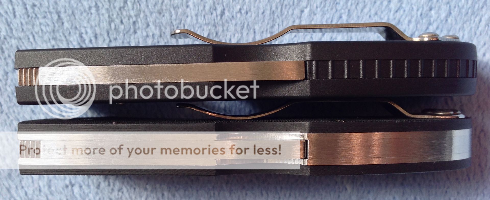

Native 5
The G10 Native 5 is indeed heavier than the lightweight version (3.7 vs 2.5 oz), but they are the same thickness overall.
IMO the G10 is far and away superior to the FRN. Better grip , feels much more solid and substantial in the hand and I prefer the weight. Definitely worth another $50 to me.
Gone is the vertical Blade play that is common among the usual FRN lock backs. The Native 5 is solid in both FRN & G10. Not sure about the Titanium, my pockets are not that full.
I had the frn native for a while before selling it. It is a tough knife and mine had no bladeplay whatsoever. I personally like g10 for the feel but think that for any reasonable task either version would suit your needs. It really comes down to feel in hand.
I believe that the FRN blade is 3 1/16" long while the G10 model is 3". Not a big deal, but it could matter in some locations and to some people.
I have been tempted by the Native 5 G10, but I suspect it wouldn't get that much pocket time. I prefer slightly smaller knives for edc.
