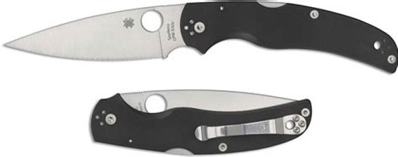

My son in law had carried his Chief around at work and mistook it for a lower end one and beat it like a rented mule. The spine had some major damage and the tip broke off. Then he found the other knife while cleaning the spare room and was heart sick. He asked me to refurbish it as best I could
So I used my sharpening stones and made a nice mirror polished swedge on the spine and reset the bevels and sharpened the edge and fixed the tip
Much nicer now and quite sharp, here it is push cutting unsupported receipt paper
Nice knife with S30v blade

Nice work. Obviously shorter. Do you have any "before" pics?
Thanks, I didn’t take any before shots and it might be about 1/8” shorter if that it didn’t need a lot to get the point back so I think it’s just the camera angle that makes it look shorter

Here’s a shot showing the blade length

Nice work...we've come to expect no less from your bench, btw...I know you said you swedged the spine, I thought it had been crowned at first blush.

Comment about the narrow swedge, it is a very flat facet mirror polished that I did using my ruixin sharpener by clamping the blade edge side in between a thin layer of leather and that allows me to set the bevel for the swedge
I made a wooden plate with a hook to keep the stone up and out of the way while I flip the knife over or when I change out the stones
