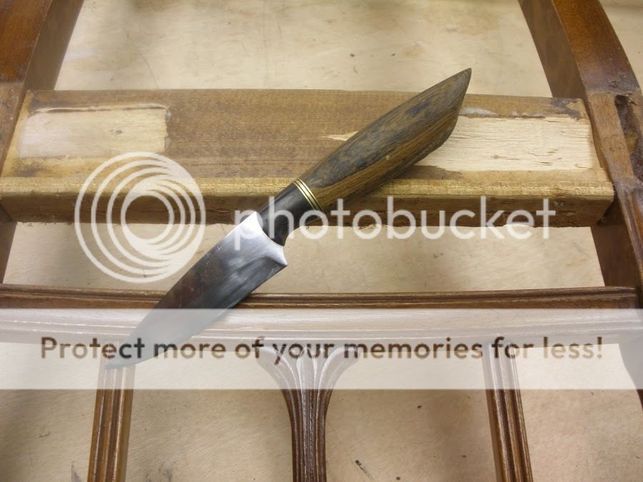

This is one of my shop knives. The blade isn't good but I like the handle. Blackwood and bocote:

Hengelo - that knife looks very nice. What it is that you do not like about the blade?
