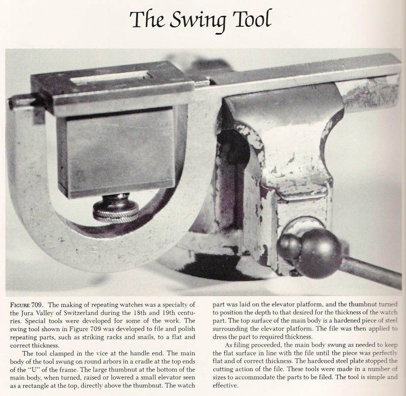

This is just the thing for some of you folder makers and I can think of a ton more uses for it.
It doesn't look too hard to make either. I think they called it a swing file.
That is really cool. Do you suppose that it swiveled to accommodate the "up and down" motion of filing?
That's what I understand Dave. The swing just kept it flat instead of canting at the end of your stroke. I understand you can still buy them in Switzerland for about $1.000.00 US.
That's why I said they didn't look too hard to MAKE !! :D
