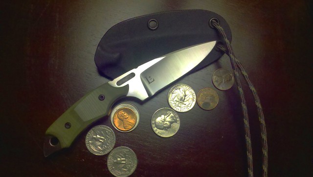

Neck knife by jpottsphotography, on Flickr
I was carrying this little knife as a necker for a while, but as the heat index rose so did the time I spent cleaning rust of off its shinny CPM 3V blade. Some folks may get away with carrying a carbon blade, but my sweat in too potent to do so. I even had some ATS-34 rust on me. It could have been the bead blasting, which is one of the reasons I coated the blade with some dura coat. I doubt I'll be carrying anything around my neck that's not coated anymore.

How does the sweat get on the blade when it is in the sheath? Maybe I am not understanding how much you sweat and how much it penetrates, but it would seem to me that as long as your not wiping the blade on your sweaty skin alot, it wouldn't be an issue. That said, I have not done anything hyper sweaty while wearing my Izula long term, so its more of a curiosity than a challenge to your worries.
I sweat a lot and in our tropical jungle humidity, my Izula do rust after each outing. Some how sweat, rain water, moisture do get into the sheath. Cleaning it, wipe dry and re oiling is a must after each day. When storing at home, just leave it unsheathed. Mineral oil for chopping board is a good cheap option. Camelia Oil and Linseed Oil are also good options for 'food prep' knives. I think few uncoated stainless steel can resist rust when in contact with sweat. I have seen S30V rust on uncoated Striders. Until Sal makes some H1 neck knives or BM makes some H2O neck knives, strict maintenance is our only recourse.
