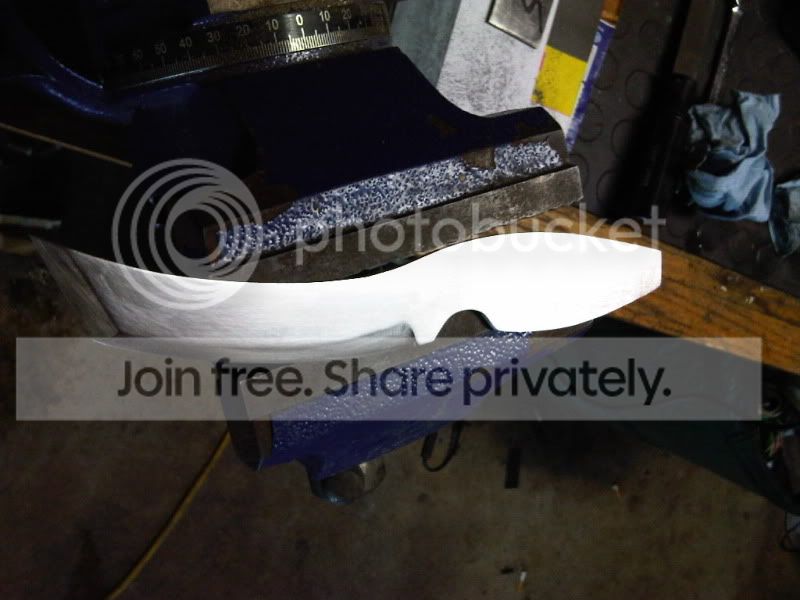

Hey all! This is my first post and I thought I'd start it with a bang.
I tinkered with forging about 10yrs ago and had to get away from it due to life intervening. But, now that I've got some free time I decided to reignite an old hobby.
So I built a forge and got to work on some stock removal 1095 knives. Forge is made from a 16"L section of 9"x9" square structural tube, 2" of ceramic wool coated with furnace cement, firebrick floor, 1" pipe burner w/ brass NPT nozzle, electronic solenoid valve controlled by PID controller which uses a K-type thermocouple to regulate the temperature. I added a second controller (not shown in picture below) to just monitor the interior temperature of a section of 3" exhaust pipe I'm using for heat-treating.
Here's the first blank I ground out of a section of 1.5"W x 12"L x 0.125"t 1095 steel.
My first heat treat with this blade was clay coat and quench in ATF. After polishing and etching the surface a bit the hamon wasn't very descipt and only went up the blade about 1/4". So I decided to quench a second time (no re-anneal I might add) but in brine. Blade was heated to 1,500 and quenched in 75deg brine. Blade was left in the brine until cool to touch. A little warping to one side was noted and decided to try an fix it (cold) in my vise and some "gently coercion". You can probably figure out what came next - SNAP! i went ahead and polished/etched the blade fragment but results were same as before - non-descript hazy hamon. I'm thinking that I didn't let it soak long enough, coupled with the 1/4" layer of furnace cement I used on the blade caused a lot of probems. I also noted some significant stress cracking on the surface of the blade probably caused by me bending it in it's hardened state and not bothering with a temper.
SO, I've learned my lesson. I've ground out a another blade to heat-treat:
...and here's the process I'm going to follow to complete this blade and hopefully get a hamon:
1) Anneal steel @ 1,475degF & cover with ceramic blanket. Let cool with forge. (DONE)
2) Profile grind & hand sand to 320 grit. Leave edge @ 0.020” to 0.040” (DONE)
3) Normalize @ 1,570degF 3 times allowing to air-cool between, reducing temperature for each consecutive step.
4) Apply thin was of furnace clay to whole blade. Cover hamon spine with clay to depth of 0.0625” to 0.125”. Form clay to desired hamon form.
5) Insert Exhaust tube into forge and heat forge to 1,475degF. (PID Controller setting: 1,430degF). Insert remote T/C into inlet of HT Tube. Int. HT Tube temp needs to be 1,475degF.
8) Insert blade into HT Tube and let come to 1,475degF. Soak for 5mins.
9) Quench in 75degF brine. Count to 5, pull blade out while still warm (500 to 400degF) and check for warpage. Fix immediately. Place back in quench.
10) Temper @ 400degF IMMEDIATELY! Temper for 2hrs, let cool 30mins, temper again for 2hrs, cool for 30mins.

Can anyone else who's had a lot of experiece heat treating for a hamon chime in and double-check my procedure above. I'd appreciate any input you could give since I would hate to break another blade that I just spent 4 hours sanding on in preparation of the heat-treat. I've done a fair bit of research since my first try and figured out a number of things I did wrong - Didn't anneal before second heat-treat, didn't keep the metal at the proper temperature to fix warpage (>400degF), didn't temper @ 400degF right after the quench.

I see two issues in your HT.
When you quench, the brine should be a tad warmer, about 100F may work better.
The biggest issue is your quench sequence. It should go ....Quench 1-2-3-4-5 pull out 1-2-3-4-5 BACK IN 1-2-3-4-5 till cool. The count is determined by experience with your equipment. I use 1-2-3, you may want to shorten your count. If you pulled the blade after the first count and did straightening, the hot spine would auto-temper the blade right down to the spine, as it would still have too much heat. The first plunge sets the edge heading toward martensite, the pull allows the spine to enter the pearlite range, and the second plunge stops the spine from allowing the heat to migrate too far toward the edge. This process makes a mix of pearlite and martensite at some point along the bevel that is called the hamon. Just the tiniest change in timing can walk the hamon right off the blade, or make it disappear altogether. I would suggest doing no straightening until after the second temper. Straighten right out of the oven with the blade at 450F. With experience, you can do many things different than this procedure, but for starters this is safer.

Thanks much!! I've read through a ton of your posts recently Bladsmth and was hoping you'd chime in! :)
I understand what you mean on the brine temp and will see if I can toss in a couple hot peices of junk steel to bump the temp up a bit before quench (currently 75 here in Houston, so shouldn't be too hard).
I'll also play with the timing on the interrupted quench a bit, but I see what you mean about getting the pearlite and martensite to start - a bit of a ballancing act it seems. (Edge cool enough to get past the pearlite nose, but warm enough on the spine to promote pearlite, and a thermal balance between the two to get the hamon). I can't rely on the clay keeping the spine warm enough to promote pure pearlite.
I'm using a furnace cement very similar in composition to APG #36 which seems to dry pretty quickly with thin layers (<.125") but with a thicker layer I had to dry it in my oven @ 140degF and it puffed up in the forge. It adhered well to the blade which was ground to 400grit, so I left this second blade at 320grit since I'll be using a much thinner layer of clay and not sure if it will stay on the blade or not during quench. If you think I should go lower on the grit (220 or 120) please let me know.
I've also read suggestions that I should put the blade in the forge when I first light it up to bring the blade up to temp slowly as opposed to sticking it in the forge @ 1,475degF and "shocking" it. Should I do this or go ahead and stick it into the forge at temp?

BTW, Welcome to the BF.
APG36 furnace cement works fine. However, you do not want it any thicker than .125". Theall too common application of .25+" of refractory compound will retain too much heat. A thin wash coat on the entire blade with about .10-.125" on the spine is just right.
On you forge. The cold spot is where the inner cone of the flame is hitting the floor of the forge. That isn't too much of a problem once the forge is fully soaked....about 10-15 minutes of running is about right. On your next forge, have the burner enter the chamber on the tangent. This causes the flame envelope to swirl around the chamber. The result is no cone and much more even heating. The flame is around the entire forge wall, not in one spot. Using a muffle (pipe) is a good system. 10 minutes of running to pre-heat the forge and pipe and the HT will be spot on.
A hamon is a finicky thing. You can do it twenty times with perfect results, and then on number 21 there is no hamon???? Careful notes and records will help a lot in zeroing in on this type of HT ( actually,good records should be kept on any type of HT).

Quench is complete. Soaked blade for 5 mins between 1,500 and 1,470degF (was trying to get as close to 1,450 as possible. Started at around 1,500 and and drifted to around 1,470 before I ran to the end of 5mins). Quenched in 100deg brine for 5 secs in, 3 out, and back in till cool. The clay on one side sloughed off after I pulled out of the water, so hopefully that's going to present a problem on the metal. Blade is now sitting in my "precision" tempering oven for the next 4 hours @ 450deg (with a cool-down planned at the 2hr mark).

Well, I finished the heat-treat last night and started polishing it up this morning. I went ahead and polished one side all the way to 1200grit real quick and assessed whether or not I was successful. After a quick etch in apple cider vinegar I could see the hint of a hamon in the metal:
If you look carefully you can see the slight haze of the hamon.
Here's what the clay coat looked like beforehand:
The interrupted quench that Bladsmth outlined worked like a champ! It's interesting to note towards the tip that a clay coat 1/8"t x 1/4" wide was rather inefectual since the hamon comes back on the blade away from the tip by about 1.5" whereas the clay only came back about 1/2". I'll have to compensate for this in the future with a slightly thicker clay layer towards the tip perhaps. Or maybe bring the clay towards the edge a bit more at the tip.
Since I had proof that a hamon was present I started over and sanded both sides through all the grits until no scratches or pits remained (220g, 320g, 600g, 1000g, and finally 1200g which was the finest I had. I tries a few rubbing compounds I had on hand but they all seem to be coarser than 1200g and just hazed the surface, forcing me to hit it again with 1200g. I need to get some finer paper and some decent polishing compound).
After I hit both sides with the 220g the hamon dissapeared. I couldn't even see it after 600g which was a little disconcerting since I've seen other's work where the hamon was clearly visible after 320g. Nevertheless I polished it as fine as my tools would let me and then hit it with a Ferric Chloride etch. Pulled it out of the etchant, rinsed it with windex (ammonia-based), and polished it with 1200g again with slow, single, draw stokes. The hamon just popped out at that point! Man was I ecstatic! First successful knife, first hamon!
Here's the blade as it sits now, waiting for a handle and the rest of the fittings:
With any luck I'll have it finished tomorrow. The different effects of etching in Vinegar vs. FeCl gave me an idea for the future. A vinegar etch seems to give the hamon a lighter appearance, whereas the FeCl etch gives it a darker appearance. May make a brother to this knife but etch solely in vinegar. Light and dark. (I suppose I could make the current blade a little lighter if I had a way of getting the blacked material out of the pits caused by the etching away of the non-martensitic metal. Anyone have a good way of making the martensite in the hamon really pop?)
In summary here's what seemed to work this time (1/8"t 1095 steel):
