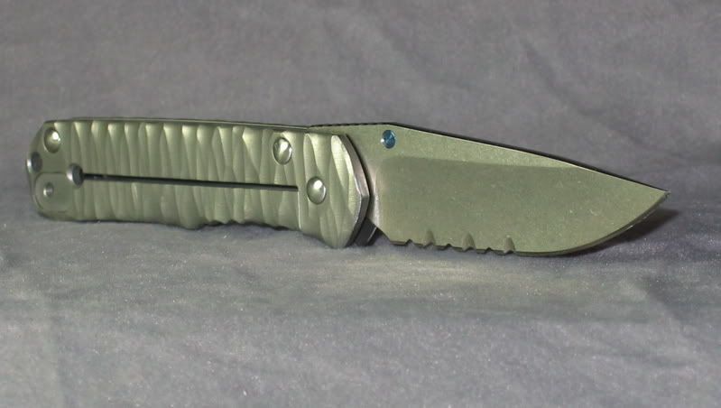

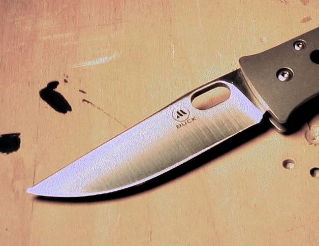

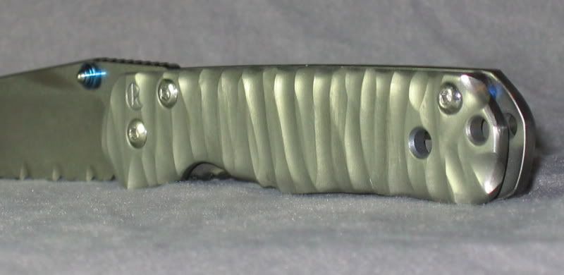

I heard my name come up--thanks. Sounds like you just need a bead blast on your existing scale.
Here's a thought for you, I use ceramic blast media, same stuff Kit Carson uses,
It produces a more jeweled, peened appearance. This type of finish tends to resist scratching better than the typical aluminum oxide bead blast.
Here's a couple pictures of what it looks like:
It's a nice finish for blades, too.
Before:
After:
