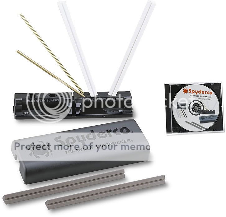

Here is a Sharpmaker
Flat,I can't even see how that thing works! He needs the type that clamps the blade and the stones are guided by rods set at an angle.These are fool proof.Mine is a Blade Master from Smokey Mountain Knife Works.Many firms make them.You cant mess up an edge withit.I like Norton stones coarse,medium and fine free hand.But there not for everyone as its an art of its own.Get the device.DM
With diamond rod, stone, grit whatever you choose get- diamond.....
You will need it with some of the hard steel.
300Bucks
Dead simple. You just go straight down the rods.

kiahs,Welcome.Your very astute.As I was meaning its not fool proof, one still must hold the knife at a correct angle inorder to achieve good results.Proverbial testing the waters maybe applicable.DM

The Sharpmaker (for me) is a lot of hype. I have one (somewhere) that a buddy gave me since he didn't care for it. It's a modern set of crock sticks. Not bad, but just doesn't thrill me.

The Spyderco SharpMaker is what I use the most. It is the simplest system of those I've tried. It is simpler and cleaner than bench stones (but not as versatile). I can set it up and sharpen the whole set of kitchen knives in about 10 minutes. No mess. No cleanup. It is not foolproof but neither are the other systems. I will never give up my sharpmaker. The other crock-stick systems might do as well, but I haven't tried any.
