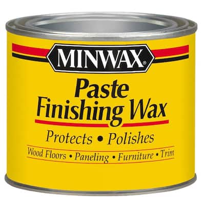

I use Minwax brand Paste Finishing Wax on my boxes and other woodworking projects.
It does not turn white when it dries.
