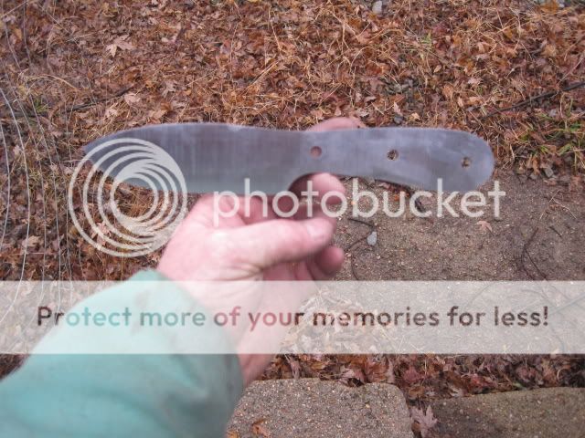

You have alot of info there and things to think about. Like I said that design is a good solid design. Started on something like that this morning for a fellow.
That pic is of it just shaped and with the pin holes drilled into the handles.
I have the grind ground in and heatreated it and it is tempering right now.
The thing with the design is it just looks like a woodsmans knife. You can see why old Nessmuk really liked that shape for his blade.
It is really neat to see the different handle colors you were able to put on yours.
I hope you are able to get it made up. You will love it.
Bryan
