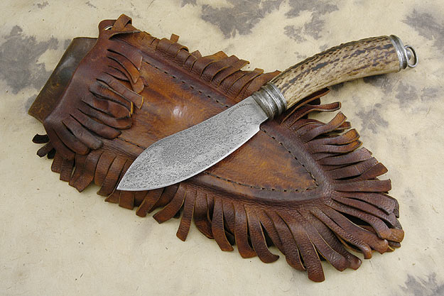

JK Canadian Belt Knife (JKCBK)

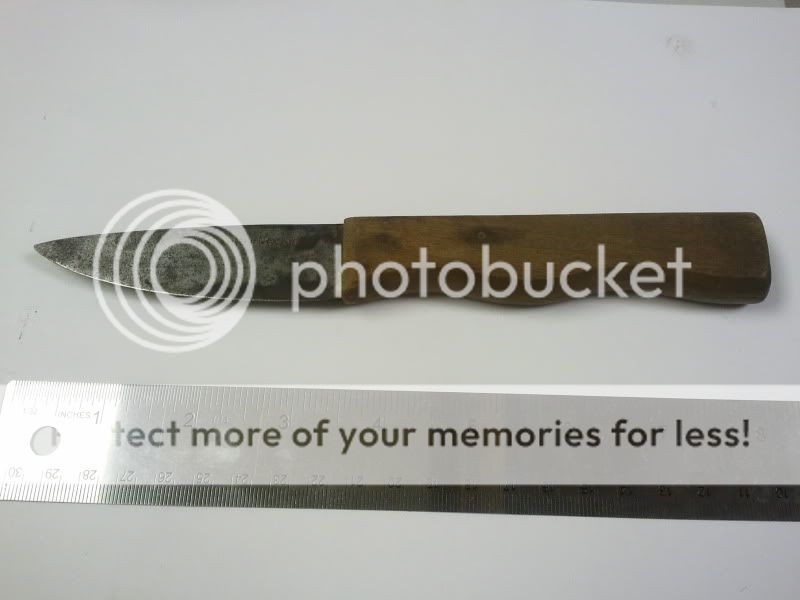

Old timer Ontario

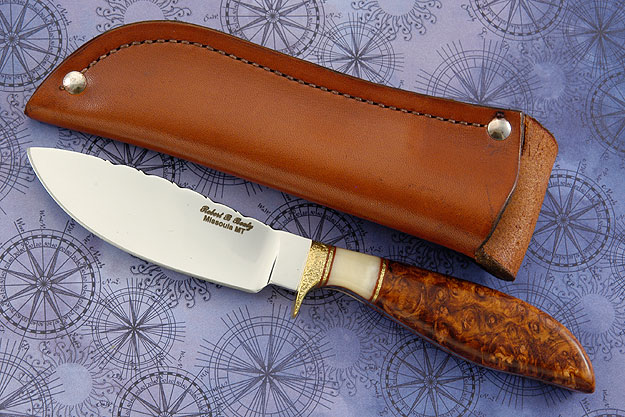

Robert B. Beaty
