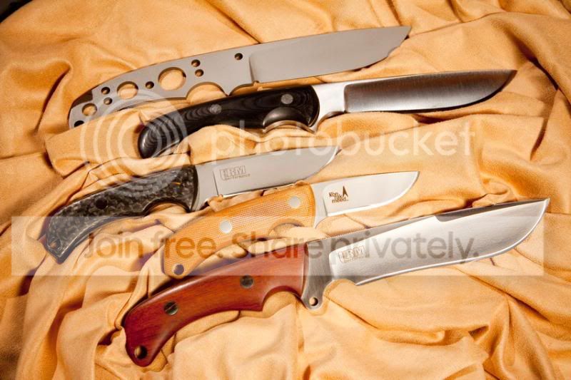

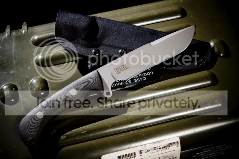

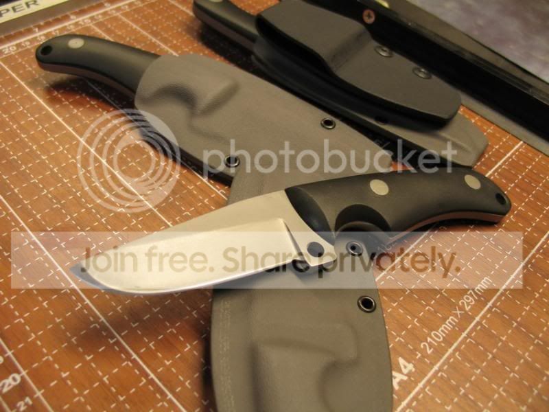

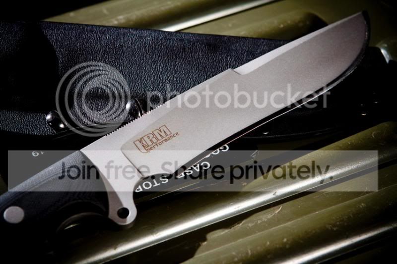

The blades and the bigger blades in the pics were about the same as required.
I use what I have which is 14 inches.
This what going to happen when the wheel is samler ( the primary bevel is too big but it is what I want for just the desidn.
