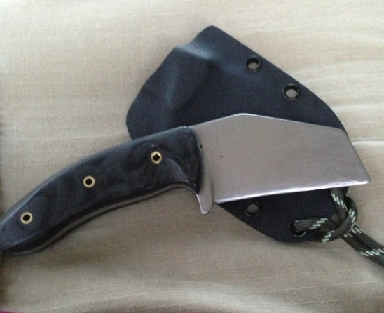

I am looking for some constructive criticism on my first three knives. I'm 16 years old and just started knifemaking, I am not that happy with the knives so far but I'm improving!
  1. First Knife:
    1095 steel, Wharncliffe style blade with brass tube pins and black/grey canvas Guycarta (micarta).

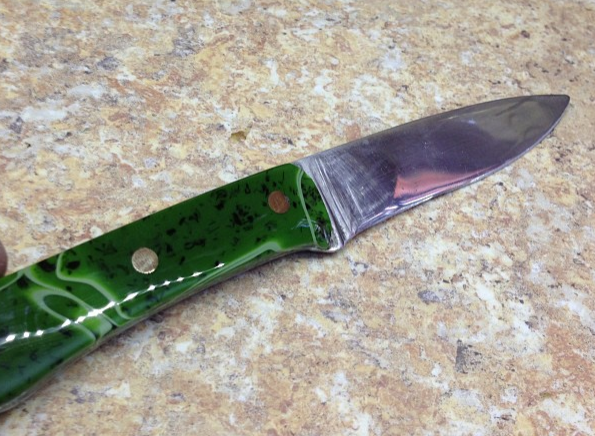

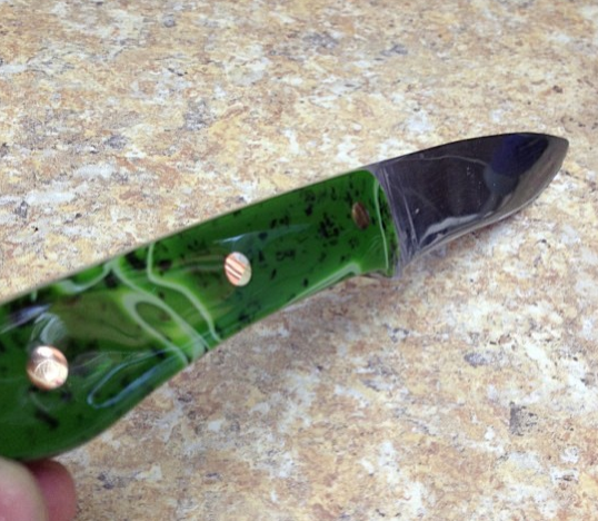

  2. Second Knife:
    Paring knife, 1095 steel, pepperjade Kirinite handle with brass pins.

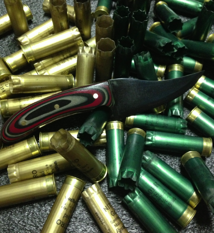

  3. Third Knife:
    Persain style blade, 1095 steel, brass pins, red/black/white paper Guycarta (micarta).

It looks like your pins are lined up pretty well and your handles are contoured nicely too.
I kinda think the first one looks too blocky and awkward, but the second one is really very good.
The third one isn't my style at all, but that's just me.

Handles are good, Blade one and three need a lot of design changes. Blade #2 is good.
#1 won't cut very well because the blade is angled to the handle poorly. Put a piece of rope on a cutting board and try to cut it....not so good, huh?
#3 would be a Persian if you ground off the huge drop to the blade and raised the point above the handle. Ads it is it is a sort-a hunter/skinner...but not a Persian at all. Also, the bevel only goes up a small amount. That will make it a poor cutter. The bevel should go up at least 1" or all the way to the spine, if you want it to slice well.

Thank you so much for your detailed criticism, blade #1 was meant to be somewhat of a fighting knife but I could see how raising the handle up could open up the uses of the blade! I will be sure to use these comments to improve my future knives!
