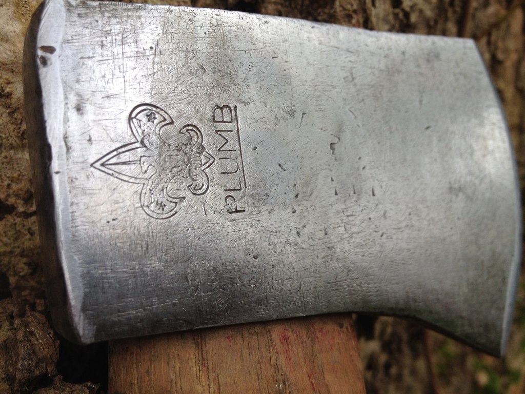

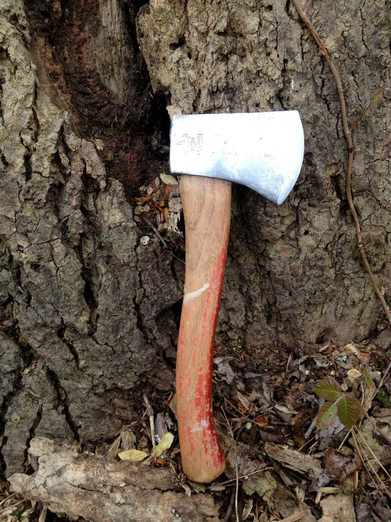

Thanks everyone for the warm welcome and advice. I had some time today and decided to work on the Plumb BSA hatchet. I got to say, when I saw some videos of guys using a hand file to sharpen axes and hatchets I thought I'd be in for a long days work, but it only took about 2 or 3 hours to get the blade to have a real nice edge. It's not razor sharp, or really sharp at all, but it now has a defined edge and at some areas will bite into your finger nails.
The handle looks fine on the hatchet, so I don't think I'll re-hang it, I might sand it down and oil it. It does have that goofy Permabond epoxy on it, so I think I should leave it be. The handle on the DB I think will need to be replaced. Plus I might have to consider using something a bit more aggressive on the DB to re profile the edge. There are a lot of nicks and dings that will take days to get out using only a file.
I did a little research tonight in regards to dating this hatchet. My dad had told me he got it when my grandfather died back in the early eighties, right before I was born. According to the information I found Plumb made these starting in '83. So what baffles me is why my grandfather bought such a small hatchet. Plus it looks older than 29 years, but I guess my granddad used the hell out of it.

thats looks nice... good work!
give the handle a good sanding and a couple coats of oil and she'll be ready to go;)
Seems to me you've learned quite a bit Huck. Never been much on small axes...But that one could sway me. Love that pattern.
Like Bear suggests, rub that haft down and get some oil into the wood. Then post another photo.
I also like the way you present your photos. Good on yer mate.
