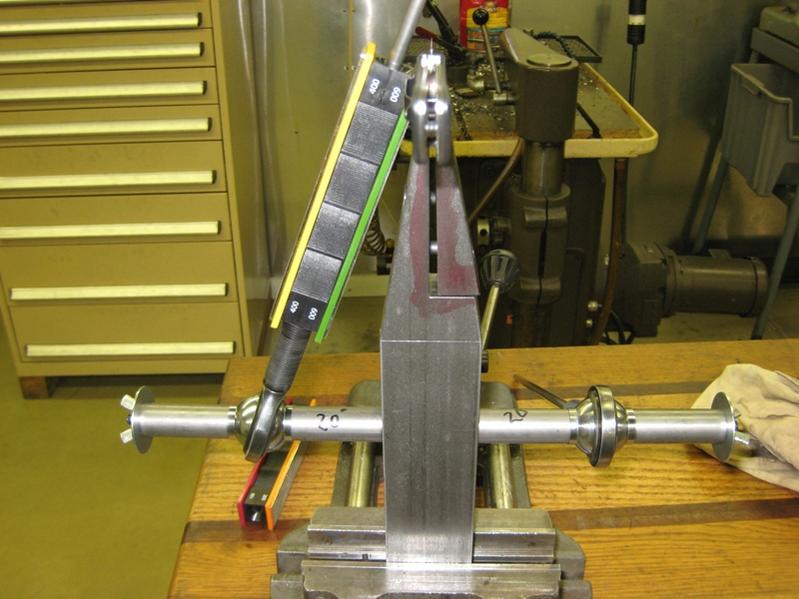

The only issue is a personal preference on how much time and/or money to spend learning it all. As for myself, I suck (so far) at free-hand sharpening, so when I want to get to hair-whittling sharpness (for fun), I use a guided set-up, similar to WEPS. And if money is no object, I'm sure you could hire a machinist to make you a custom sharpening rig. There are a few machnists on these forums, and a couple of them have built either custom sharpening rigs, or done custom modifications to things like the WEPS and EP. But dang, that's kind of extreme.

P.S. The machinist Beltman posted photos of the modifications he did to his WEPS set-up. Thanks to ChangeOfSeasons who pointed out this thread! :)
