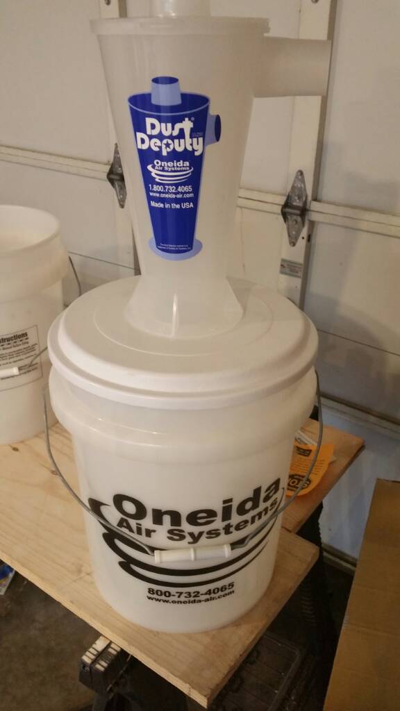

Speaking of dust my local woodcraft was having a sale the other day and look what I picked up for $10. Just need to find a way to rig something up below my grinder now!

I've been wanting one of those. I have been using the bags in my vac, which has allowed me to not have to clean the filter as often.
