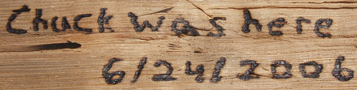

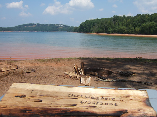

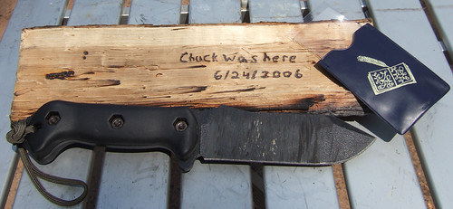

Here is a couple of pictures I took after playing around with a fresnel.
