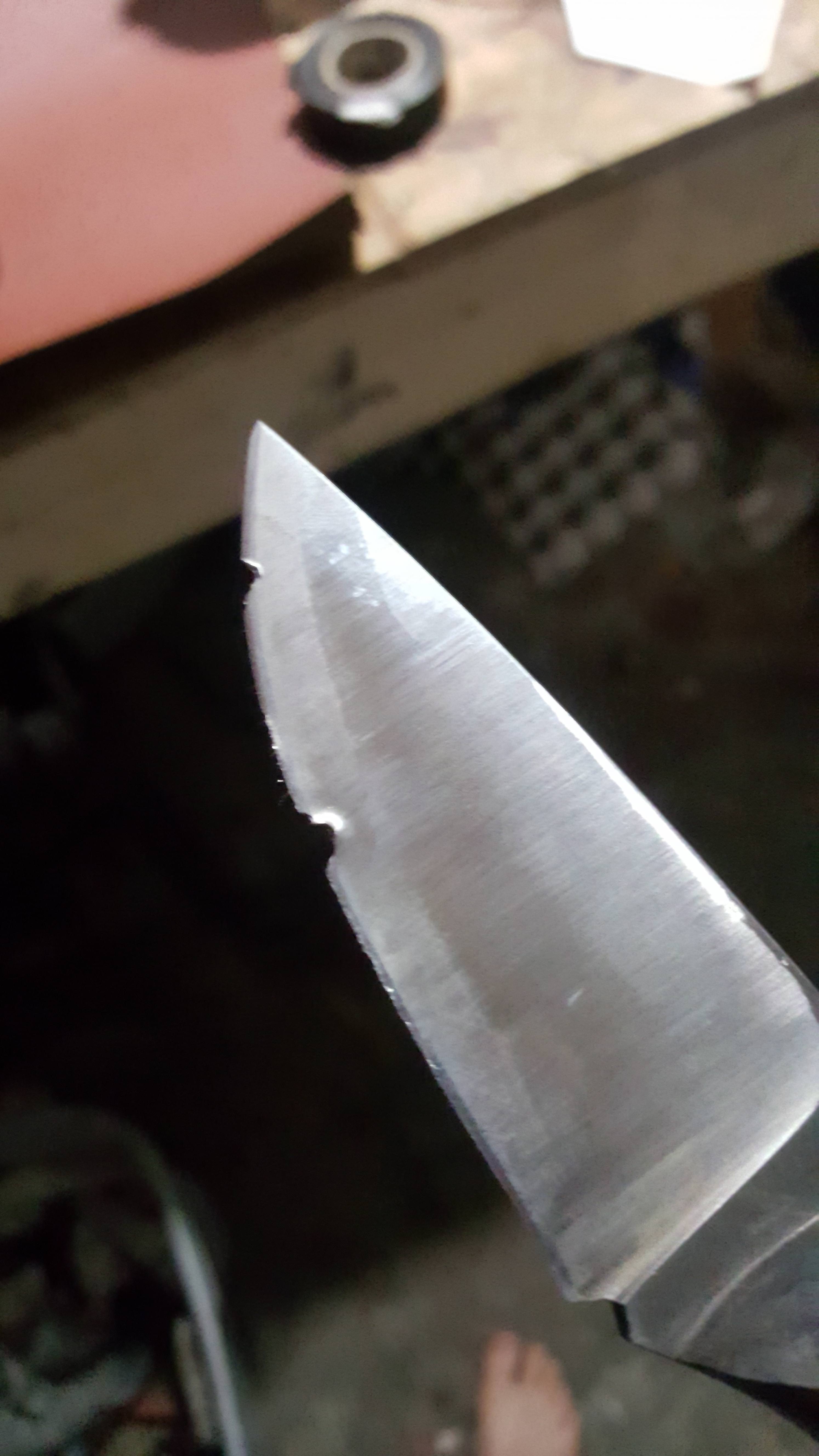

Alright guys well i just did a batch of 4 knives in 80crv2. Heat treated to past non magnetic then quenched in parks AAA. Temper 2x 2hours @400°
Well i decided to do some rough testing. Cut paper, chopped through wood, and hammered through a 16D nail. Heres the results:
Pretty depressing. I had 2 of them posted for sale and immediately took them down. I tested those 2 with just chopping through wood then a cut test and they passed.
Padauk hunter i have i tested the same way. And it passed the nail test!
So i heat treated another knife except tempered it once at 350 for 90min. Exact same result at the first knife. Due to injury i wont be forging so should i just stick with sending blades out?
Or drive on and figure out the HT?

It's hard to say there was anything wrong with your heat treat just because the nail chop results. The first chopper I ever made from 80CRV2 looked like that after chopping antler, maybe not quite as bad but disappointing. It was 60 RC, I tested it. But i was being really really optimistic with how thin the geometry was. It was closer to a kitchen knife than a machete. Grinding the edge back to .020" and sharpening and the same knife sailed through antler chopping without any damage.
If you want to send me coupon or blank to harness test for you to know what your process is doing I'd be happy to.
That's a good point. I try to make my edges pretty thin, these were roughly .012 they did fine hitting plywood and still cut. Didnt really design then to chop through nails lol
Ill do a couple up and send em to you John, i appreciate it man.
