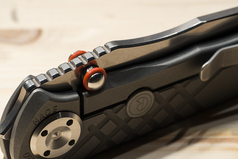

As for O-rings: a guy known here as Andrew Nik once replaced O-rings. He bought them in a radiocontrol toys store (Silicone O-Ring P-3). OD 6 mm, ID 3 mm
http://www.amazon.com/HPI-Racing-6819-Silicone-O-Ring/dp/B000BLNS0W
pictures by Andrew Nik
rings are available in many colors including glow in the dark
