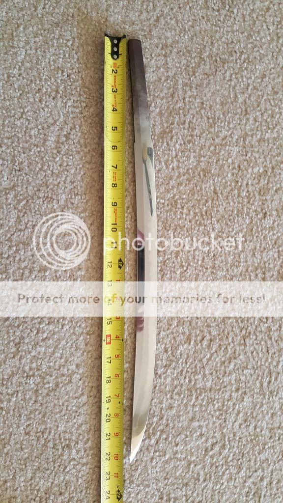

Hey guys, I needed some help building my Pavel Bolf naginata naoshi wakizashi. It came bare blade and I needed someone who could make a habaki for it.
I would also need some advice on how to shape the saya mouth to properly hold the habaki yet be able to clear the wider munouchi. I was thinking of making it aikuchi style.
Thanks!
I assume you meant monouchi. Just make the habaki as wide as the monouchi. On your blade, that should be about a normal size habaki. This will make the koi-guchi wide enough for the blade to pass the monouchi.

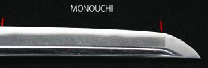

You both are mistaken, the monouchi is the few inches below the yokote considered the sweet spot for cutting. You must mean the "Machi". The machi is where the habaki goes, it consists of the hamachi (ha-mon edge) and the munemachi (mune-edge), with the "ha" being the cutting edge and the "mune" being the spine edge.
Your sword is not a naginata naoshi. It is a shobu-zukuri wakizashi.
The habaki matches the geometry of the sword at the front where it stops at the hamachi. It does flare towards the nakago end ever so slightly.
See attached photos:
Monouchi (approximately):

Uh no, this is a naginata naoshi, it is wider at the monouchi than at the machi with a diamond cross section. I would have to make the habaki unusually wide at the ha machi in order to clear the tip area.

Being wider at the monouchi than at the machi has nothing, I repeat nothing to do with the habaki. There is no reason for the habaki to clear the wide area of the monouchi. Do you know what a habaki is or it's function? It goes on over the nakago(tang) and stops at the machi. It goes no further up the blade.
It is also irrelevant how wide your sword is at the monouchi or being diamond shaped.

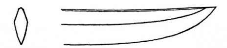

If this is modern made just as shown then it is neither a naginata, nagamaki and certainly not a naginata-naoshi !! You can call a Volkswagen a Mercedes, but that doesn't make it so. It may be an artistic rendition of or a Naginata-naoshi inspired reproduction at best.
Naoshi means remodeled or reshaped. A naginata naoshi is a remodeled/reshaped naginata or nagamaki. Both Naginata and Nagamaki were pole arms with long nakago. Occasionally, they were cut down and reshaped into katana or wakizashi. The nakago was shortened and the blade reshaped. Not in every instance, but the overwhelming majority had distinctive grooves carved into them, called "naginata-hi". They may or may not have a yokote.
But without the naginata-hi (groove) yours more closely resembles a shobu-zukuri inspired shape:

Hm I always thought that if a blade has a naginata shape (ie wider towards the tip) then it would be considered along the lines of naginata naoshi. I know that there is often confusion regarding certain types of blades, such as what we are discussing. So I can pretty safely assume that without naginata-hi, as on my example, it would just be considered more Shobu-zukuri. Now I am more clear on the meaning of naginata-naoshi. Naoshi means to remake or redo, so it pretty much applies only to old re-purposed naginata that have been cut down. My understanding of the term was completely off. I have not seen examples of shobu zukuri swords being wider at the monouchi than at the machi area which was why I automatically assumed naginata style.
I understood your first point about it being wider at the base than at the machi and being able to clear the wider monouchi area. I also understand the function of a habaki and what it is. I think what I am getting caught up on is my mental image of the habaki being fairly wide at the base to create enough width for the tip, then carving out the saya ana. Maybe my imagination is just going crazy. I will have to search more to see examples of saya ana.

One typo I wish to correct. In my first post I stated, "It is a shobu-zukuri wakizashi". I clarified it in my second post, however, I want to be sure you understand that it should have read, "it more closely resembles a shobu-zukuri inspired shape".
Here is something I am not 100% absolute on. I do not know of any criteria for this blade shape which says it can not be a bit wider in the monoucchi than at the machi. It is my understanding that shobu-zukuri (Iris leaf shape) is based on a shinogi-zukuri shape, but without yokote and they are tapered from the shinogi to the mune. Though, I have seen a couple of papered examples which did not appear to have the tapered shinogi-ji. If they were tapered, it was ever so slightly.
But, regardless this is the closest related shape to yours. Here is an example of one(Note I normally do not use examples which are for sale, but this was the only one I could dig up and it is only used in an educational capacity)

After reading your last post, I understand what your concern is (i think). Your concern(correct me if I am wrong) is the wider monouchi fitting through the koiguchi and the habaki still holding the blade securely. There is no doubt that it requires a more precision fit, but it will work.
Look at the example I posted yesterday of the big naginata. http://yakiba.com/Naginata_Naotane.htm
Notice how wide the saya is at the wide end, but also look closely at the nakago end. Look too, at the habaki on the blade. See how the blade just clears into the mouth of the saya, but almost instantly begins to flare in order to accommodate the wide portion of the blade.
