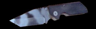

I've got one other recommendation for you that comes from the absolute opposite end of the spectrum (one that I wasn't even going to mention until you stated a desire to carry a fixed blade ;)). Whereas the Whitewing folder might be described as strong yet elegant, without question, IMHO, the folder that comes closest to the strength and security of a fixed blade these days is the Strider Custom Folder, model AR or GB (drop point and tanto blade, respectively).
Please understand that this is a completely different animal from the Whitewing. The AR and GB are overbuilt in every sense of the word. They are big, thick and not lightweights by any stretch. One disclaimer up front; the AR and GB are liner locks technically speaking, but with their massive .100" thick titanium liners and precision lock-up, I doubt you'll ever find a liner lock that instills you with a feeling of greater confidence.
The blade length (for legal purposes) is also longer than your desired max. While the specs list a blade length of about 4", you'll see in the photo below how there is a full sized finger cutout included in the choil which results in an actual cutting edge closer to the three inches you desire. This finger cutout also provides an added level of safety and security when gripping up on the folder. Even if the lock somehow managed to fail (though I can't imagine what force on Earth would cause this), your index finger would simply get pinched between this cutout and the handle, thus protecting the rest of your fingers from contact with the cutting edge. The security features of these folders are rounded out by a very positive liner ball detent which holds the blade firmly in place when in the closed position.
The .190" thick blades are not only crafted from BG-42 steel, but they're also heat treated by Paul Bos; a super combination in my experience. Likewise the G-10 scales are very highly textured and provide a secure grip under most all conditions. No Wharncliffe blades are available on this one, but the tanto bladed GB model may have the right combination of straight edges and sharp points that you're looking for.
Striders also come with unbeatable lifetime warranties.
Note that the newest Strider Custom Folders being produced differ from the photo below in that they now feature fully flat ground blades.

The blades are .250 thick not .190:eek: :eek: :eek:
I think that the Buck-Strider folder is .190 thick.
Jeff
Jeff,
I don't have mine on me as I type this, but I believe both the Buck version and the Strider Custom Folder feature .190" thick blades. Here is a quote from Mick Strider as found in a thread he contributed to last year:
Top : Strider/Buck .190 ATS34 blade, .070"Titanium liners, G10 scales.
Middle: Strider folder w/spear point. .190" BG42 blade, .100"Titanium liners, G10 scales.
http://www.bladeforums.com/ubb/Forum63/HTML/000039.html
Thanks Bronco, I stand corrected. I thought that they had .250 inch thick blades because that's what all of the Strider fixed blades have.
