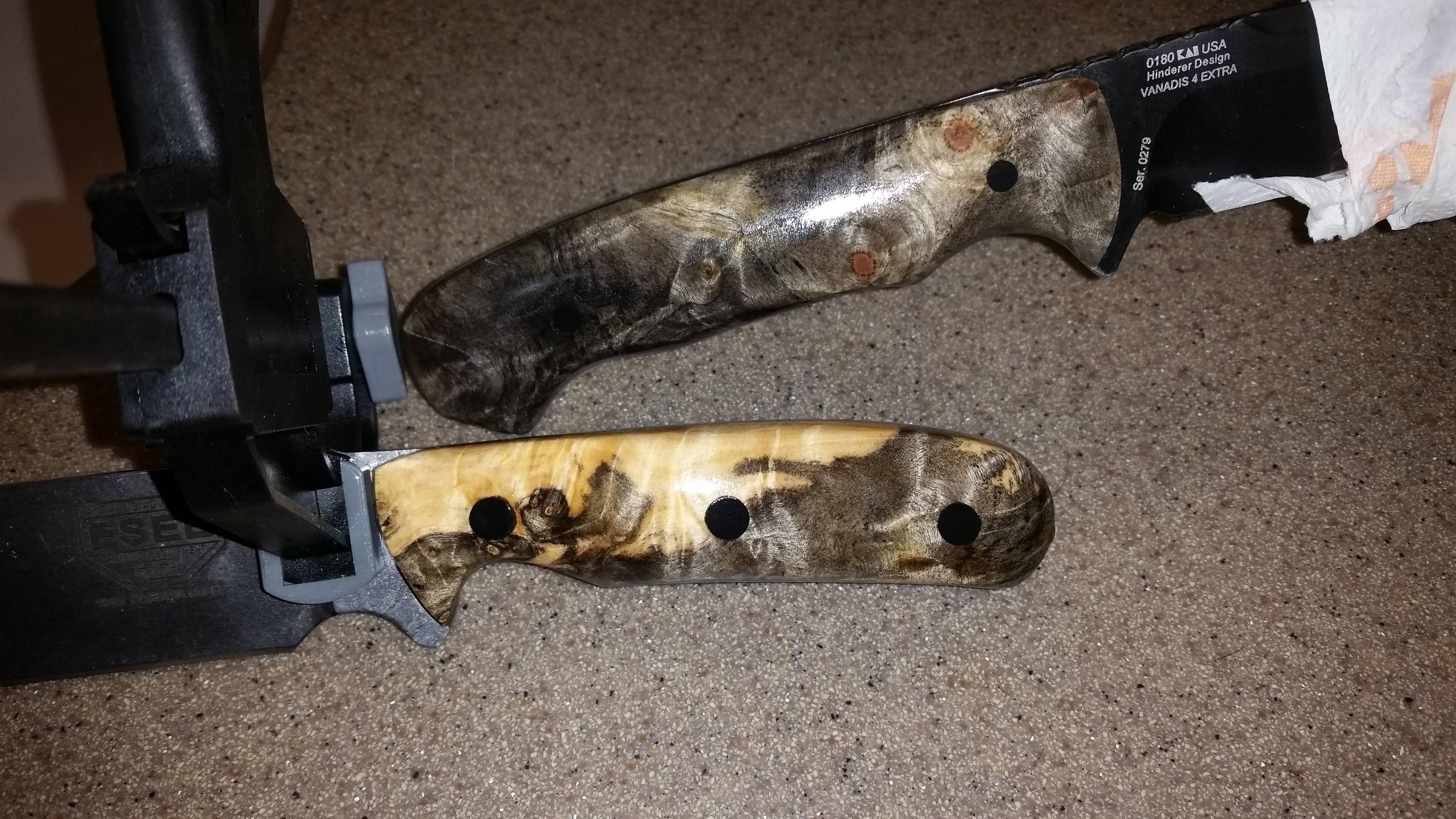

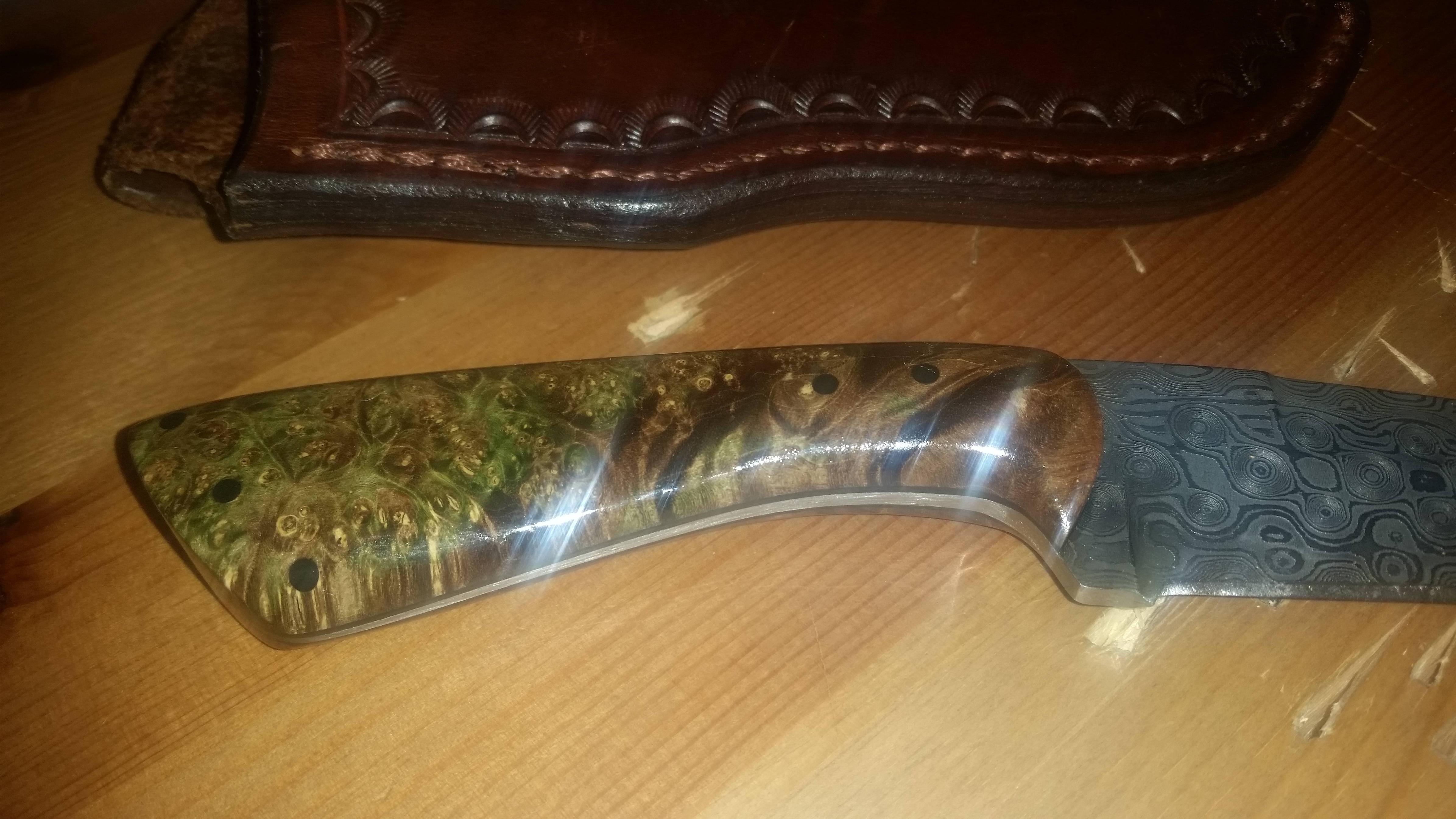

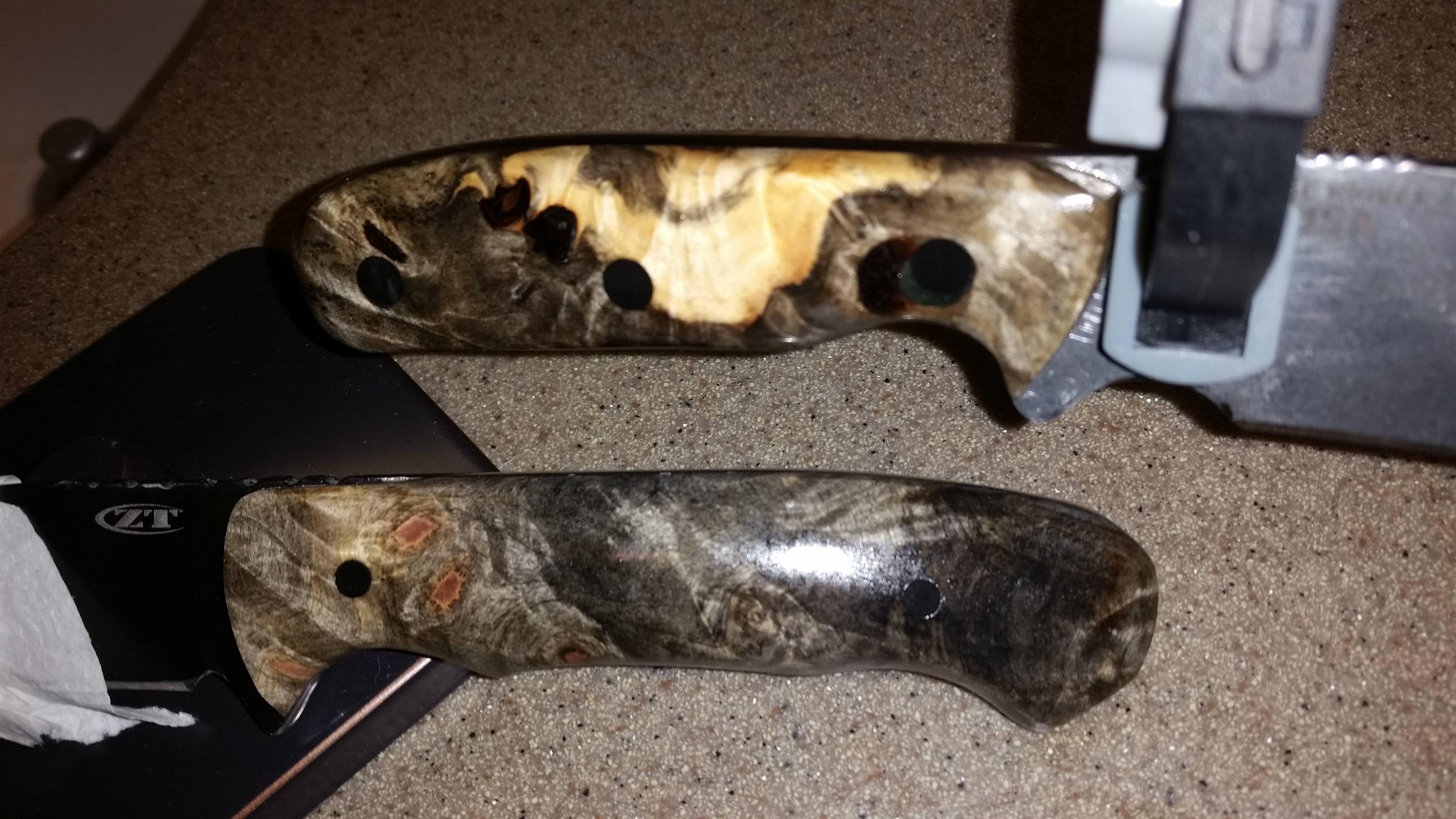

or find something stabilized that's naturally the color you want. for the amount you need nothing's going to cost too much. hell some of the denser woods come in colors that look like they're dyed naturally-unless you want blue;).
Dyed (Backwoods Knives)
Vs undyed (work in progress, Esee and ZT by me, blocks supplied by John Doyle)
agreed and they not only look nice but can have amazing hand feel. some of the densest act almost like a heat sink . bocote is really pretty as well and you might also look at bubinga.
