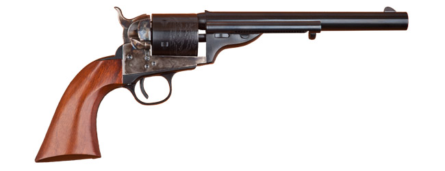

Howdy folks, sorry if this doesn't belong here but I didn't know of a better place to ask. I have a customer who wants a set of grips for his revolver. He's not too picky about what type of bone he wants, but I'm having trouble finding anything. The grips need to be at least 4.5"x3.25"x1". I've looked at giraffe, camel, buffalo, and even cow. I see revolver grips made out of bone all the time, where are those makers getting their supplies?
I have never seen a set of bone scales that wide (3.25")? Is it an extra large revolver?
It's a Uberti reproduction of a Colt 1872 Army Conversion "Open Top".
No larger than a Colt 45 I guess. I used to cut walnut scales for Colt grip and I don't remember cutting them that wide. But I don't know the size as it was years ago. Maybe some one else with chime in and be more helpful.

He specifically mentioned Giraffe, Camel, and Buffalo. I don't think he was too into the cow even know he mentioned it too. He wanted something a little denser. I did find a big piece of Giraffe bone on ebay that might be just big enough. It's not cheap, but he may go for it.
Thanks fellas.
He went for the Giraffe Bone, so I bought a 13.5" section of leg bone off fleebay. The narrow end looks to be 3" wide at least, and the end with the joint is a bit wider than that. :D
