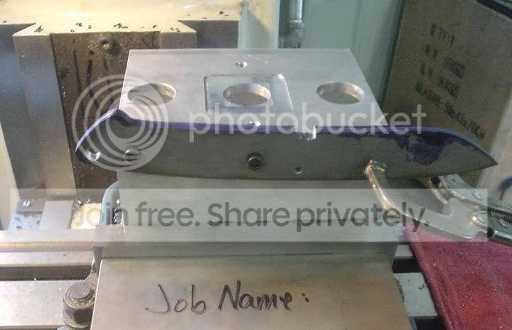

need help from a milling guru - tooling plate
Oct 9, 2003
1,561
I know we have many helpful machinist types here, and I have some questions about making an aluminum tooling plate to work on both fixed blades and folders.
questions are
1) what type of aluminum?
2) how thick should plate be?
3) where should I GET the Al?
4) what size should I tap the holes which will be used in clamping pieces?
Thanks in advance:D
Bill

Hey Bill :) I have many different fixture "plates" for many different machining applications on the knives I make.
Something else you might consider is a tube like shown in these pics. They're 4" x 4" x ~ 5" - 6" L. ; 1/4" wall thickness and are the most versatile work platform(s) I have in the shop.
Honestly, I don't think it matters much if they are 6011, 6013, 7075 or whatever. If you go to a shop looking for tube, take whatever they are willing to cut for you.

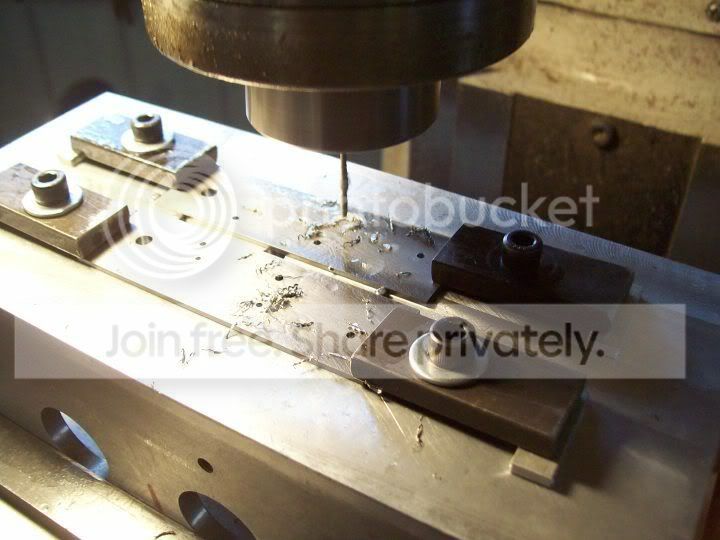

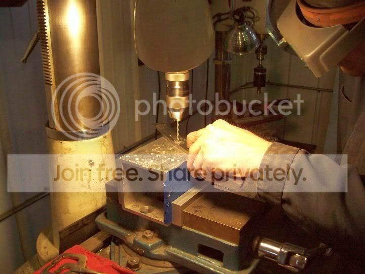

I use them for simple drilling ops, working off the top ................
I can also work off the front or back .............................
One of the great things about it being a tube is the fact I can easily clamp straight edge, stops, etc. for repeatable alignment, like shown here for drilling guard pins ..............................................

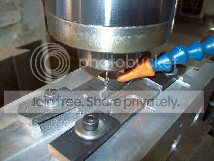

Or fixture off the top for more complex machining operations ............

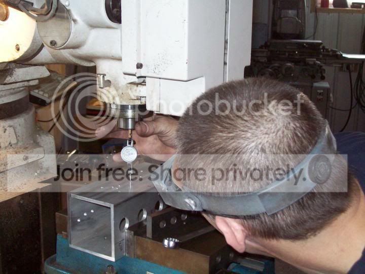

For the more complex fixturing I will usually add a tooling hole that I can pick-up with an indicator. This way I can take it out of the vise and replace it at will and easily have a repeatable 0/0 location to work from for repeat operations on different knives I make...................

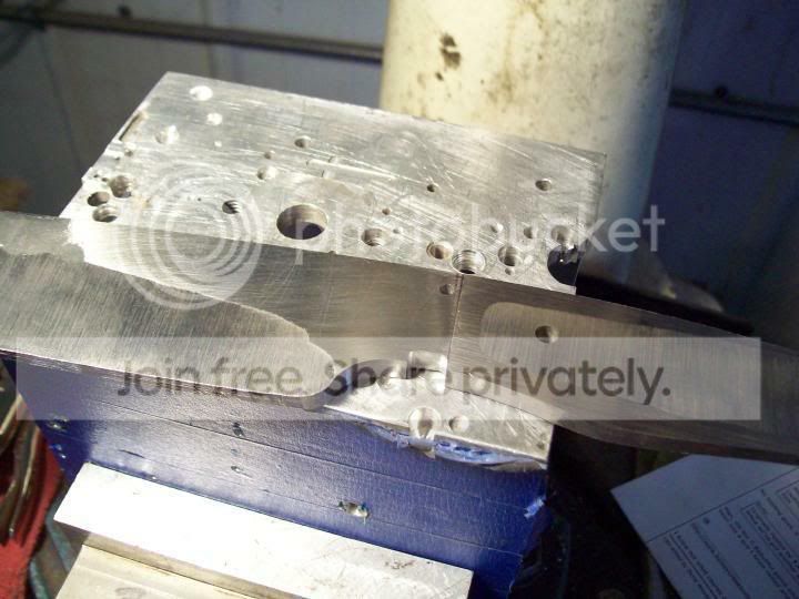

I have several of these tubes and have, over the past several years, worn a couple out. After they look like swiis cheese I cut another length, buzz a fly cutter over the top to skim it flat and start a new one ;)
Very, very handy !!! :thumbup:
