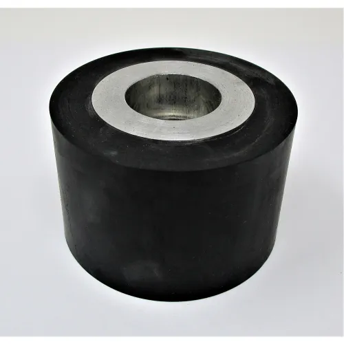

I have a Wilton 4103 square wheel grinder that I purchased around 1980.
I have a parts sheet that is dated 1983. I need the part no. 504028 1593 Idler Pulley Assy.
This pulley is plastic. It is 2" wide and has a diameter of 4 1/2". Inside the plastic pulley is stamped "Part # 1578-52.
The idler pulley assemblies I have been able to find are rubber and made for a later model Square Wheel Grinder.
Any help would be appreciated.
Wilton was purchased by Jet ?
You may find parts for it as Jet
12345678910, thanks for the information. The square wheel grinder parts Jet has listed is for a later model than what I have.
Their idler wheel is rubber and not the same size as the plastic one on the older grinders.

12345678910, thanks for the research. It looks like the Jet Parts you listed are just what I need.
Thanks again.
