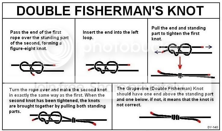

The double fisherman's knot would be a good one for this application, and the knot in the photo could actually be one because there appear to be four 'wraps' of cord in the knot.
Dang, Doc.... I looked at your diagram and thought 'that doesn't look like a double fishermans knot'. But I followed it and got a result that did look like the knot that I know and love. I must play with your method some more. Thanks for that. I actually may have seen your diagram in the past, but because I was familiar with the knot I didn't look closely. Perhaps your method might become more automatic than mine... I have to look carefully at what I'm doing to make sure the wraps stay crossed if you know what I mean.
I picture it a different way when tying it, with the loops held quite high so that the tail end can just be passed through the knot in a straight line from one end....as the black cord indicates in the diagram below.
