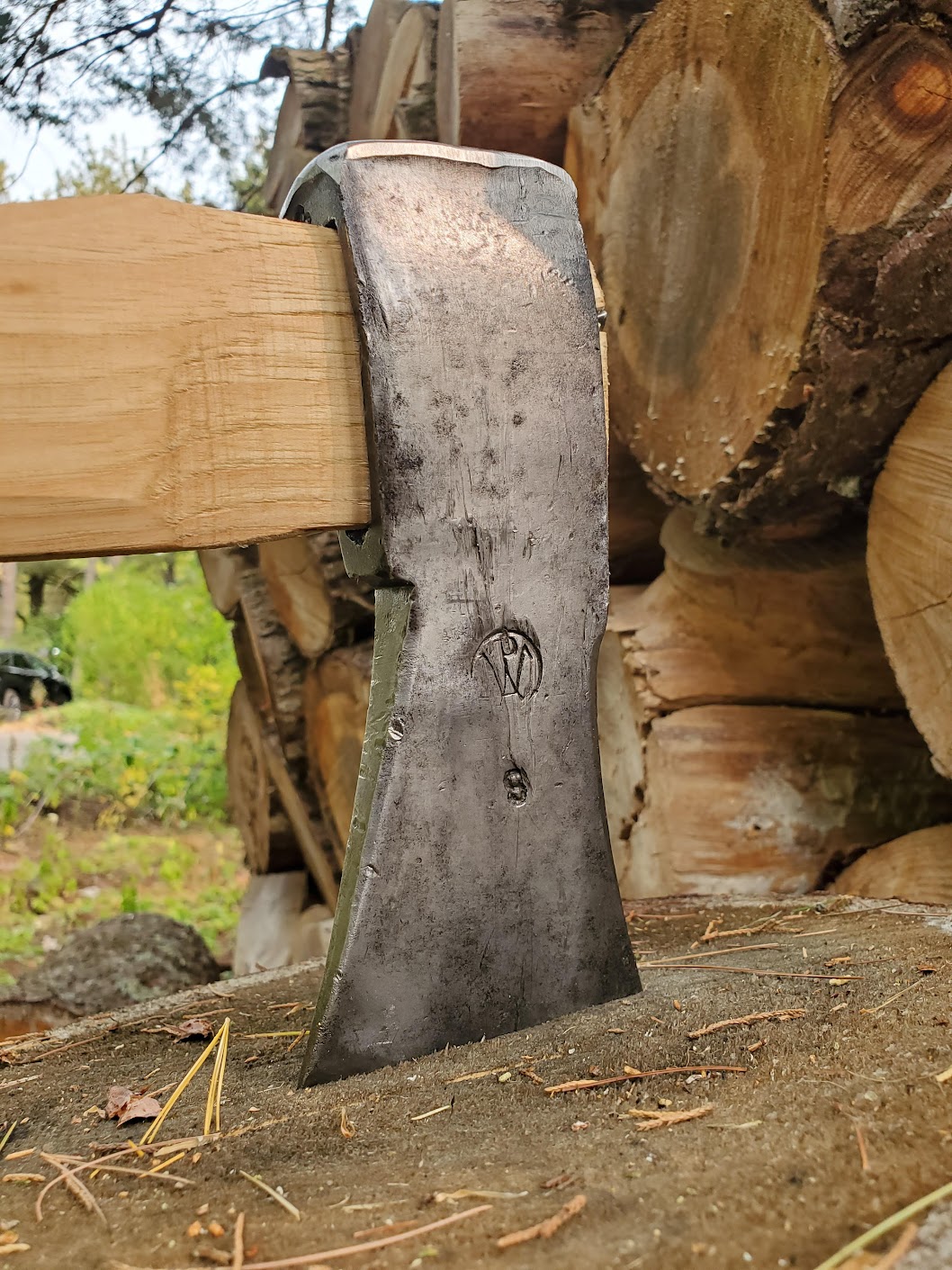

Hi there, was recently visiting Switzerland and picked up this axe head a farmer was selling. It has "HB" stamped on one side, which initially made me think Hults Bruk, but the HB looks like it was maybe added later. The proper manufacturer mark isn't anything I've seen before. It looks like maybe WP? Or PW? I'm guessing it's of German manufacture, but that's just a guess.

Hey all, circling back on this as I've finally gotten this thing cleaned up and hung. Gave it a night in a warm electrolysis bath, a little polish, cleaned up the mushrooming, and gave it a new edge.

No new markings appeared but that PW is much more clear now. If anyone else has any thoughts on this thing's origin, love to hear 'em.

Couldn't find a perfectly straight handle that'd fit, I thought that'd be most appropriate, but ordered this one with an octoganal cut and I think it pairs up nicely.
