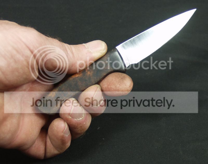

I figured the best way for me to learn would be to start in one area of knife making and get good before I move on to the next. Since the equipment I have on hand are woodworking tools it only makes sense to start with handles.
The two knives here are made with blade blanks provided to me by Adam Michael knives. I really like their shape and the tapered tangs.

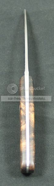

On the first knife I cut the scales from a piece of end grain ironwood scrap. After epoxying on the scales I sanded away the excess and did a little shaping rounding off the edges with a folded piece of sandpaper. It doesn't look as bad as my previous attempts, but I am wondering if I should be doing things differently for a more gracefully shaped handle. ....or should I just keep doing things how I am and hope to get better in time?
The scales are about 1/8" thick. On future ones like this should I attempt a swell in the middle or taper the edges more?

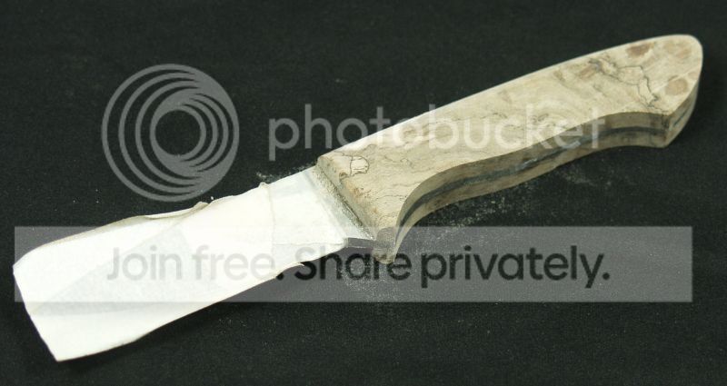

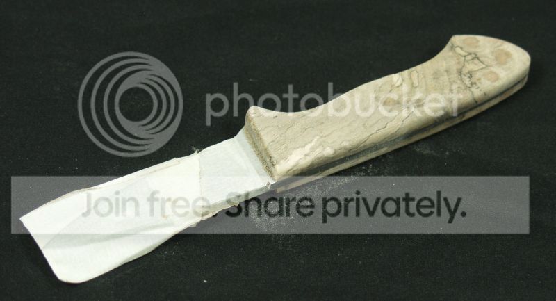

This next one I have sanded away the excess and was starting to round the top edge. I figured I would wait to hear what advice you guys give before I go any further.

Are you using hidden pins,or no pins at all. Other than that their looking good.
On the second knife those long ears on the front of the scales at the finger guard look good but have a tendency to break off along the grain if bumped a little hard.I usually round the front of my scales.
Stan
It is probably a mistake but both of these are no pins at all. The blanks were drilled for pins so the no pins thing was probably a mistake. I was thinking with such a small knife that will only be used for stuff like opening packages and such they wouldn't be necessary. ????
Right now to me, my handles look like flat pieces of wood with rounded edges. I was hoping to learn to a achieve a more refined look. I plan to taper down the ears on the second knife. I was waiting before going further to hear if someone told me a different way to do things. I read somewhere about using a strip of sandpaper like a shoeshine rag for shaping. Should I try that?

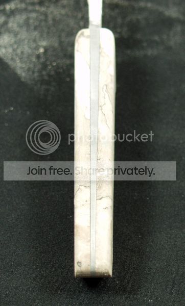

I am also getting a really thin dark line between the tang and the wood. Is that normal? or... should I clamp the scales tighter?

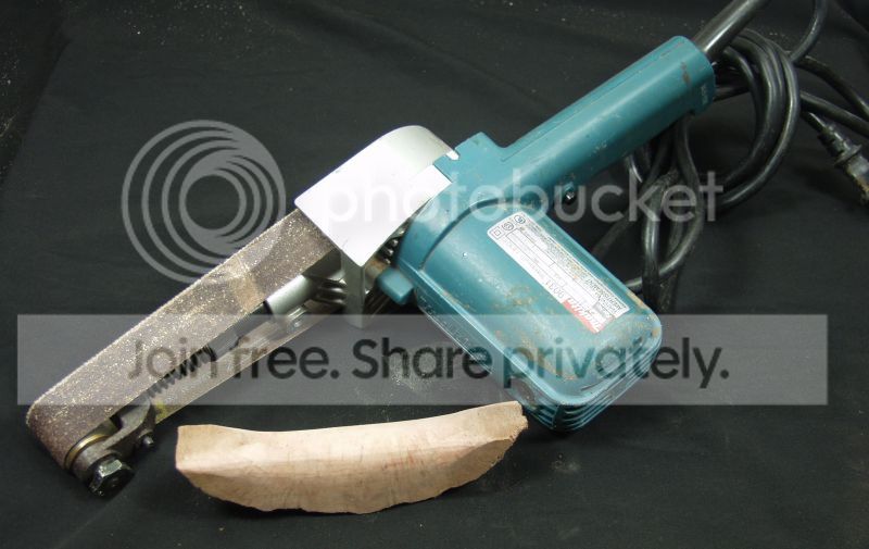

thicker wood and like a 1x30 belt sander would do you wonders buddy!

Ed Caffrey had a good tip not too long ago about not taping the blade. If you get more into fancy contours, it gets tougher to keep things looking symmetrical if you can't sight off of the straight balde.
Nothing wrong with using rasps and files if you're used to woodworking tools. Maybe some way to clamp the blade end securely would help. Do the pins next time, a scale may pop off unpredictably.

I found this is one of the tool cabinets. Just tried it on a scrap and it seems to round off the wood pretty easily. Now, if only I wasn't such an uncoordinated klutz. Guess I better set up a vise in my work area. This thing is really good at launching stuff.
That line is from not having a good fit to the tang,sand the back of the scales on a flat surface IE apiece of glass or surface plate until no light is visible between the scale and tang.you don't want to clamp too tight or you will squeeze out the epoxy.

If you hold your empty hand as if you were holding a knife you'll notice that the natural
opening is really more egg shaped than round or oval. I try to mimic that in my handle
cross section (unless I have a design reason not to). Smoothly rounded all the way
around but with the top a bit more circular and the bottom more tapered. IMHO, this
feels good in the hand and in use as well as looking good.
I also like palm swells, my most recent handles narrow a little just past the guard then
swell to the palm and narrow a again at the butt (all in terms of thickness). For this
reason I very seldom consider scales less than 3/8 thick (though mostly prefer to cut
my own from blocks anyway).
On the other hand, there are people who really dislike all of the ergonomic handle
treatment...
One tip I will give is to finish the area of the scales near the ricasso before you put them on. Once they're on you'll constantly worry about scratching up the blade. Tape, or if you can do it with corbys, rivet the scales together and shape them together and take them to whatever finish you plan to do the whole scales. Having some kind of pins for attaching those scales would probably be the preferred method to be honest. Besides if you're essentially practicing here why not attempt putting some kind of pins in there. If you screw it up it's not like you'll have a hard time finding more wood :p.

I also finish the front end of the handle since it's alot more difficult to shape and sand it when its stuck on the knife without damaging the ricasso.
The thread was helpful. I liked the photo that showed how he sanded the bevel in the handle and then shaped. At first it seemed like an awful lot of material to take off but now I can see how it would make the shaping easier and more even.
