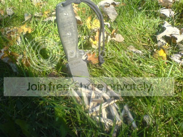

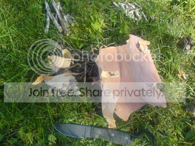

Making a fire is very rewarding. Here are some pics. Not very good(it was taken with my cell phone). First one is what I first started out with. The tinder burnt out too fast, so I had to get more dry leaves.
My starting supply(weak I know) And you can see the stolen bark basking in its glory.

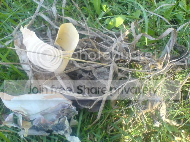

Close up of my tinder. You can see that grass I was talking about.

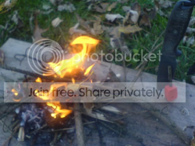

Finally, fire! Picture a little blurry. But I made fire. Woo!!
