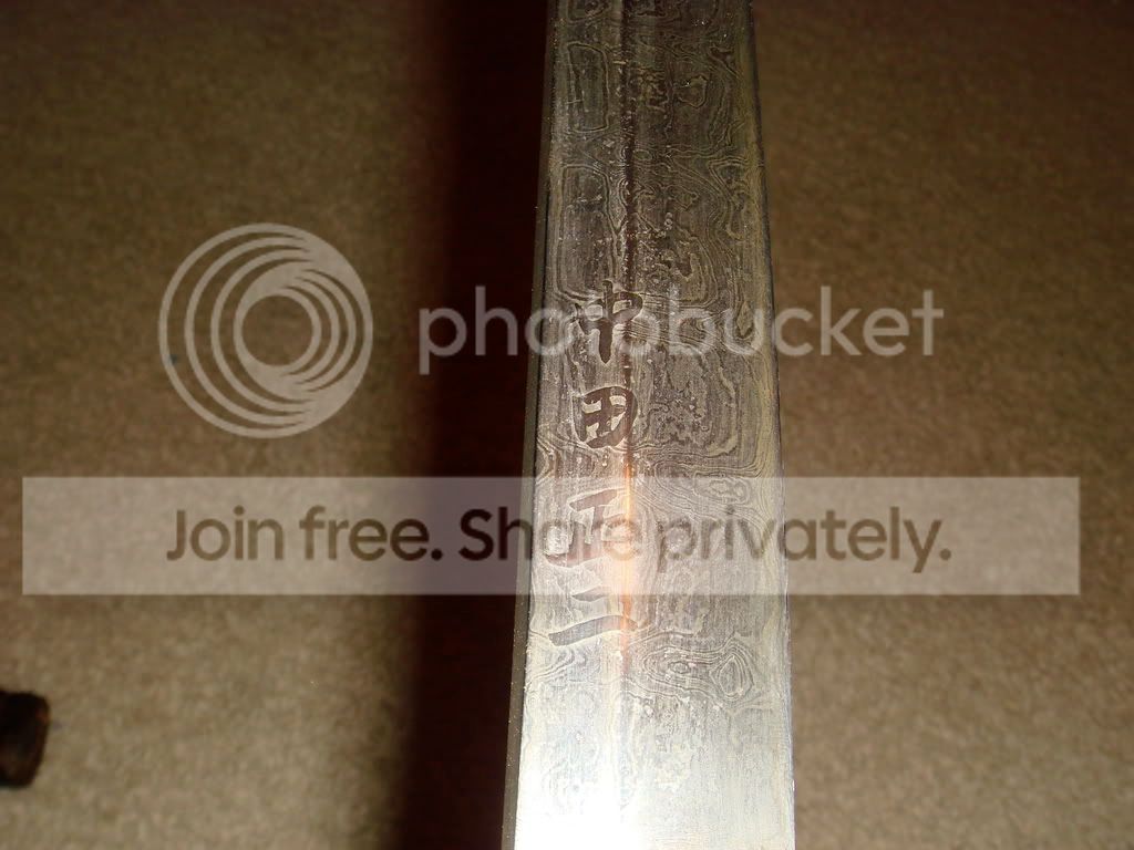

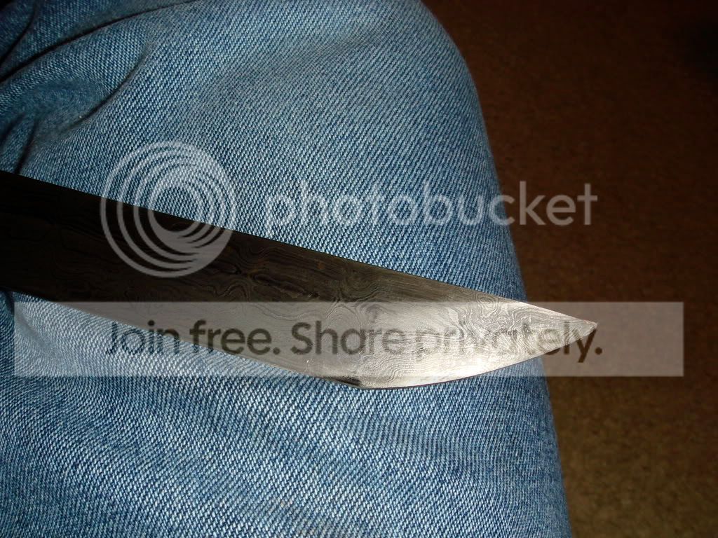

hey everybody!
i just recived a sword as part of a trade involving a commissioned knife. the blade is kinda rough... but has alot of "promise" especially if i were to refile the blade.. or even re heat treat it and give it a hamon. but i dont know if i should.. is it better to leave it like it is? the blade is conpletely dull, and doesnt look like it was ever sharp.. and is VERY dull.. like what my blade look like before heat treat.
would it be sacrilege to re heat threat or repolish this blade? can i anneal it.. and straghten the blade.. file it.. and heat treat it? or is it better to save it as is?
all you sword smith's help would be greatly appreciated.. what is it that i have?
thanks so much!
here are pictures!
let me know what you think
thanks so much
~chris

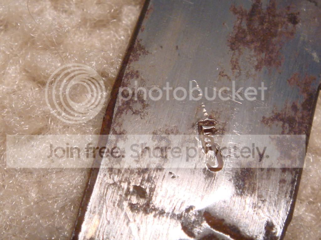

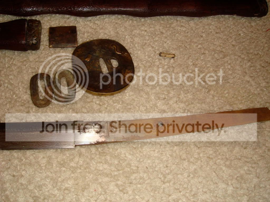

Chris, what markings are on the tang of the knife? Can you give us some more shots of just the tang? This is not a plain Gunto as Mike mentioned. My amateur opinion is that it's a Chinese made sword.

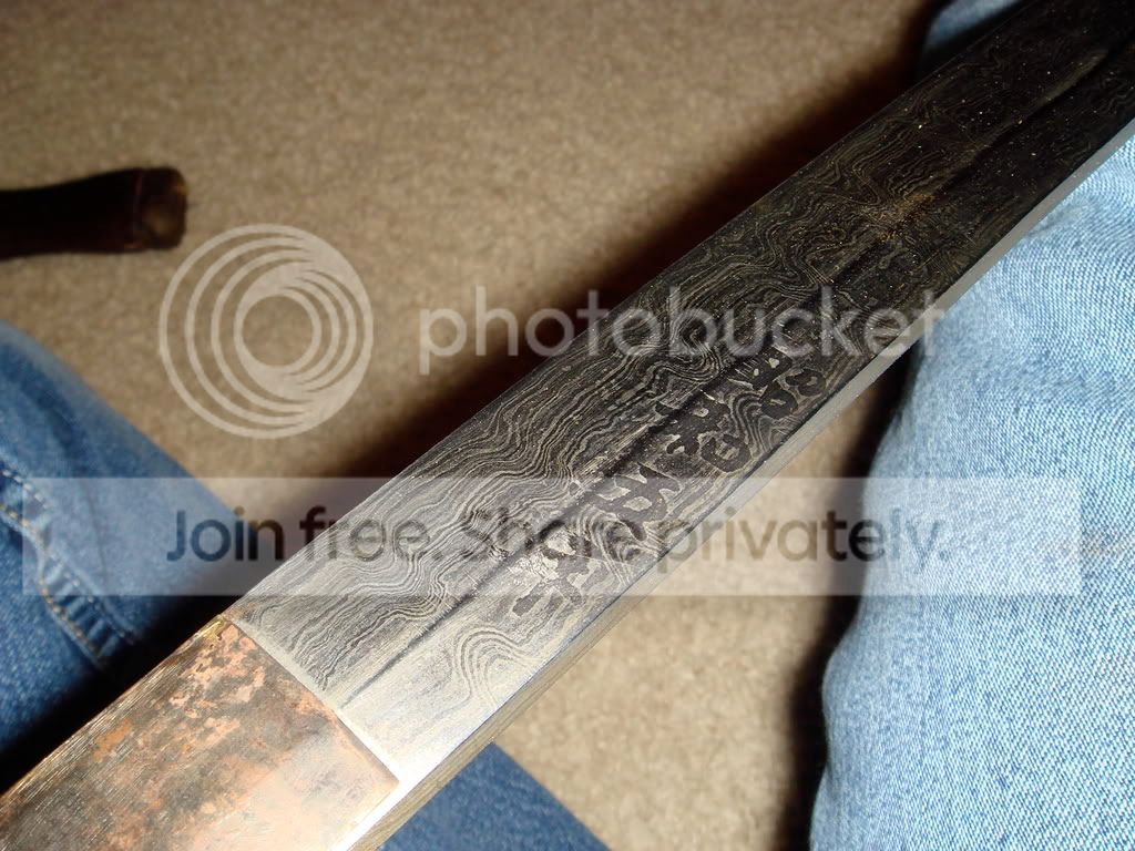

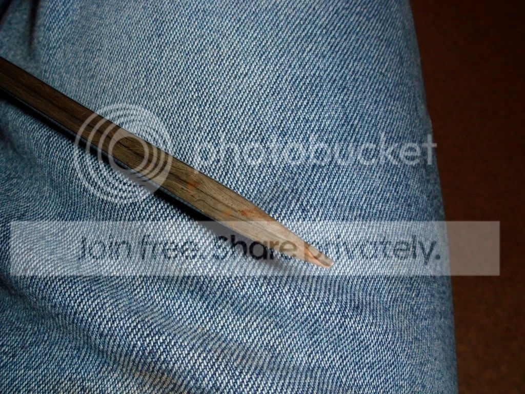

The writing on the blade is Nakata Shouji, the name of the smith and the second marking is Showa-5 the year 1930. I don't know of any blades that have etching like this, especially not one that's this old. The kissaki also looks a little wrong to me.
You should really take this over to the SFI Nihonto forum for better info. I'd still like to see more of the tang and any kanji that might be carved into it.

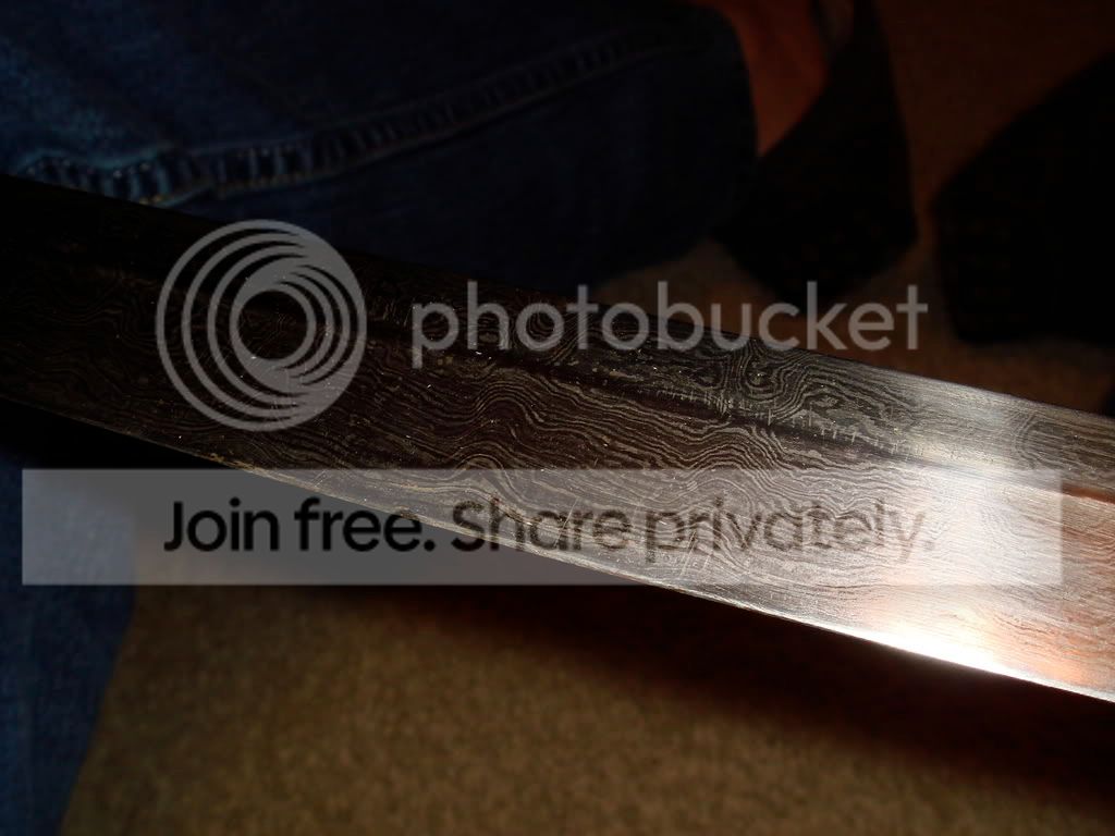

That should say sword above, sorry. Also, I wanted to mention that you will rarely, if ever, see patterning like this on a nihonto sword, it looks etched to me. That would go along with the writing, but neither would be period for a Showa sword in my opinion. Again, my amateur opinion.
By the way, the rust on the blade looks a bit red, does it come off on your hands when you handle it?
What acridsaint said. Check it just to be sure but the absence of a hamon and the lack of a sharpend edge and the fact that it has been etched to show the patterning makes me also beleive that this is a chinese made sword. the patterning sort of resembles what the gassan smiths were doing but is not correct. also the mune machi and the ha machi are offset and of the thousand or so genuine swords that I had the pleasure of looking at in Japan last summer not one of the had etched blades or offset machi.

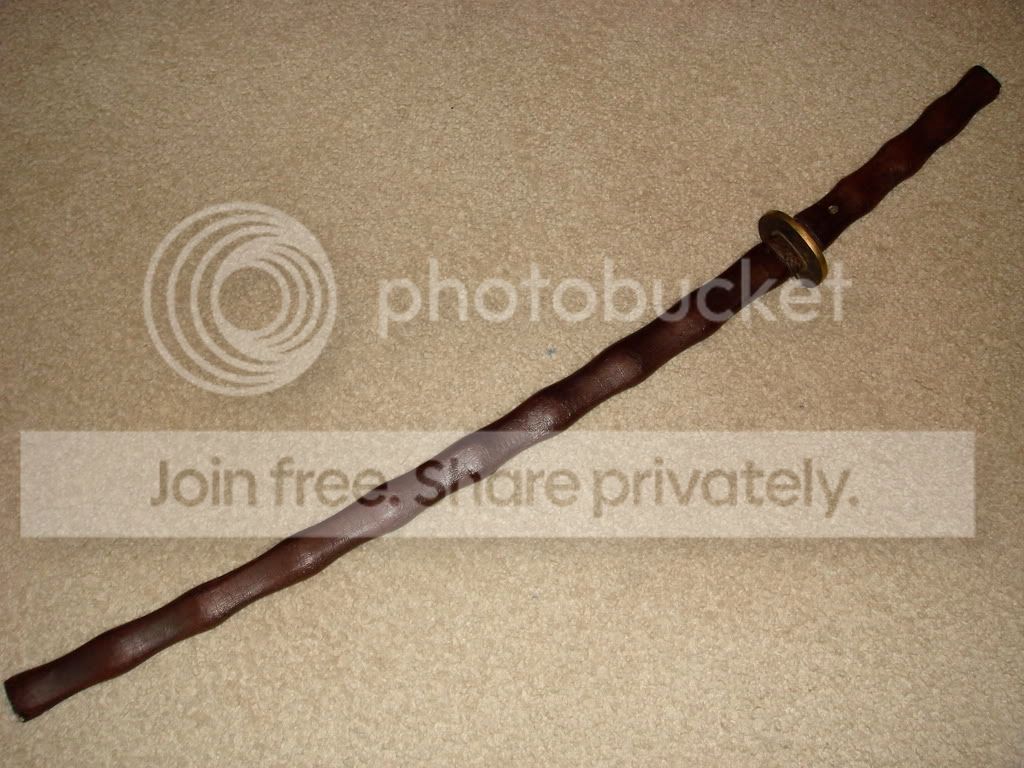

Hello Chris. I have to go with what has been said before. It is a chinese made copy of a katana. Check out some ebay listings under WWII militaria-japan and see what pops up. They seem to be flooding the market with them. Other than that I have not looked at one up close and personal. I would say have fun with it and see what turns up, with your skills it should be interesting.

the picture shows the only marking on the tang.. sweeet! this is actually just what i wanted to hear.. (yeah the rust is new.. it comes off. and there were no other marks on the tang. so... nada.
i am thinking that i will completely redo it... anneal...straighten.. draw-file... heat treat.. polish.. then maybe mount it.. or let someone else do it. i am DEF gonna have fun with it.

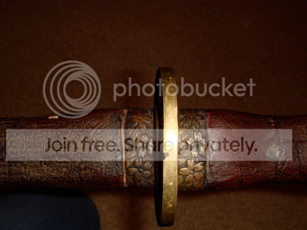

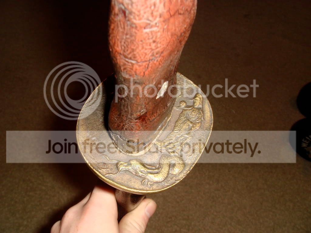

Here's what I see:
ha-machi mune-machi don't line up, very rare on a normal sword, swords with this usually have a really nice habaki
missing yasuri(decorative file marks)
rust looks bogus(muriatic acid?)
nakago(tang) looks off to me, poor geometry
hada(grain) is a ridiculous, I'm sure it is mono-steel
hada and writing are etched in
writing is not engraved, also that writing would usually go on nakago
stamp looks like nonsense
fittings look like cheap castings with fake patina
I've never seen a saya like that either
kissake geometry and hada are off
I doubt there is anything to anneal or heat-treat...

Yes, Chris, I'm fairly confident it is one of those Chinese "Thousand Year Old Damascus Samaurai Swords" seen on ebay for $49.95. It is amazing how much work they put into them. The steel is usually non-hardenable, or just barely hardenable. Have fun with it.

hey guys.. this isnt mono steel.. first off.. the patern isnt repeating.. plus.. there are two spots where this is a slight open layer. also.. in the tang you can see the patern even where it wasnt etched. but i agree the geometry IS off.. and all that.
so it wont harden? hmm thats too bad. i might be able to make some San mai with it as someone sugested.. casue it is very pretty.
thanks for the help yall!
~Chris
do a spark test on the butt of the tang to determine if it has enough carbon to harden
