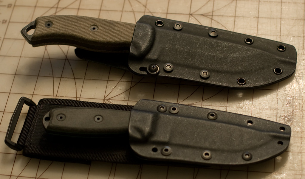

I am trying to switch out my ESEE-3MIL-S (with molleback) to a Blade Tech Clip and am going to use the molleback from the 3 with my old rc-4.
I am trying to fit the molleback to my rc-4 but am having some trouble figuring out the exact way to do it. Do I need to use the screws that come with the Molle Locks to fit the sheath to the Molle Back?
Also, I looked at the picture and it seems that all of the holes in the kydex are filled with screws. It doesn't depict which ones connect the kydex together and which ones go through the MB, though.
Also, what should I do with the extra screws for the ESEE-3MIL that I removed from the Kydex? Do they need to be used to screw down the RC-4? It looks like the Blade Tech Clip has two screws that I can use to connect it to the sheath.
Can anybody that has one this let me know how they did it? Which screws they had to remove (if any) from the unaltered Kydex sheath and where they got the screws from to attach the 4 to the MB from the 3 as well as which holes are designated for the MB and which ones are to keep the kydex tight. I currently have the top left and right ones with a screw in as well as one in the bottom right, along side the back side of the knife. I removed the screw that was in the edge side, second from bottom since it looked like that hole needed to be used with the MB.
I noticed that the kydex is going to go down about an inch or so lower than the ESEE-3MIL did.
It sits a little lower on the 4 and you might have to move some screws around. The holes only line up one way.
Do I use the screws that attached the 3 to the MB? They seem like the only ones long enough to attach it to the MB.
Some of the holes in the Kydex sheath for the 4 seem a bit bigger than the others. Those holes are too big for the screws that came with the 3-MIL. Do I need to remove the screws in the 4 sheath and re-arrange them? They aren't long enough, though......that's where I'm hung up........I'm assuming I should remove all the screws from the 4 sheath, figure out which screws from the 3 will go through which holes that line up on the MB, then attach the screws from the 4 into the other holes to make sure the retention is proper and then go ahead with the 3 MB screws that I have.
I think that's the way since the pictures with the provided literature show that all of the holes are filled with screws.
If anyone can let me know how they did it or if I'm right or wrong I'd greatly appreciate it! :confused: My girlfriend is on her way to pick me up and wanted to get it done before she got here.........or I'll need to pack everything back up and start again when we are supposed to be having 'hangout time'.

You use the screws that attach the 3 to the molle back to attach the 4 to the molle back because they're long enough. The short screws that are on the 4 sheath might need to be moved or even removed and set aside and the longer screws can go in their places. Then if you want to take the 4 off the MB you take the longer screws out and put the short ones back in the bare sheath. Make sense?
http://eseeknives.com/esee-4-instruction-back.pdf
I have the middle 4 through the MB

I ended up using the screws from a bag of Molle Locks and they were long enough.....so I guess if you have them you can try to use them. I also moved a retention screw down....the knife is super locked in now.
The holes don't line up quite right.....you might need to bend the back of the sheath a bit to get the screw to go into the post. Once you get it connected and start screwing it in the post will go through and it'll line itself up.
Otherwise, go to the hardware store - 8/32 Oval Machine Screws (I think) in 3/8", 1/4", or 5/8" and then find some screw posts (also have another name). I was able to find Stainless screws (cheap) and aluminum screw posts to screw them into (more expensive).
That's odd that the MB wouldn't come with screws. You do have to put the nut on the front side of the sheath as Dizwolf showed.

You don't need to order another molle back or the locks to get the screws.
They are common screws sold in almost every hardware store.
They are 8/32 threaded Phillips (something...pan?) head Machine screws. I think the short ones are 1/4" or 3/8"...bring in one of the short screws with so you can get a set that is the next size up (3/8" 1/2" 5/8").
The back pieces might be called screw posts or something similar. Bring that in too so you can measure the height against the other ones. Buy a couple sets to make sure you get the right size.
I found my screws in stainless and the screw posts (or another name I forget) in aluminum. You can also buy small rubber washers from the drain/toilet section that fit perfectly if you want to use those....i got some to play around with.

Worked like a charm guys. And now that I really looked at the picture and re-read adam's post I'm good to go now. It's not gonna come apart at all now. I read nut and thought bolt! I guess the nut is more like a post but now I completely understand. Thanks!!!
If you get a 3 or 4 with MOLLE Locks then the screws from the MOLLE locks will attache the MOLLE back. When you purchase a MOLLE back from us separate it does not come with any hardware. We assume you already have MOLLE locks or Boot clip which have the correct screws and posts. Mike
