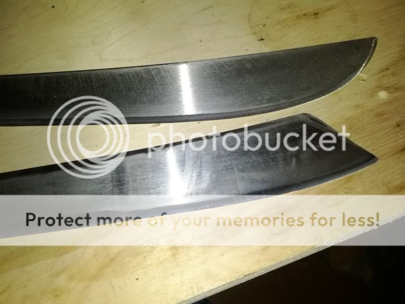

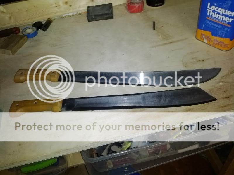

I just sharpened up 3 Trameltina machetes the other day. All three are stupid sharp for a machete. I used a Harbor Fright beltsander to convex the edges and then polished on a buffing wheel with white compound. It took less than 5 minutes a piece.
Kinda hard to tell here, but:
