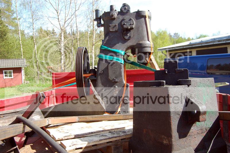

Hi!

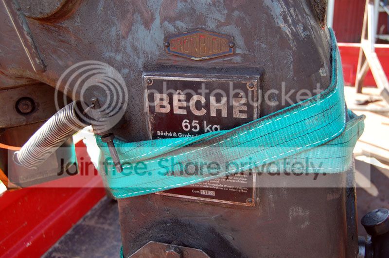

For about a year ago I bought a new power hammer, a beché 65 kg, and today I was able to run it for the first time.
There was a big problem with hammer, the ram did not go up and idle at the top of the hammer cylinder as it should.
It goes up and and down with a full stroke length hitting the bottom die every time. It does not hit the bottom very hard but it hits it.
I did not find any obvious causes to the problem but will take a closer look tomorrow.
I had a similar problem with my other hammer that I was able to fix, the reason was problem with the valve. The beché does not look any thing like that hammer so I have no idea where to start to look.
Maybe any of you guys know where I should start to look? It not a very uncommon hammer and should be fairly similar to a Nazel.
Here are some pictures of the hammer from when I bough it.
Best regards
Jakob

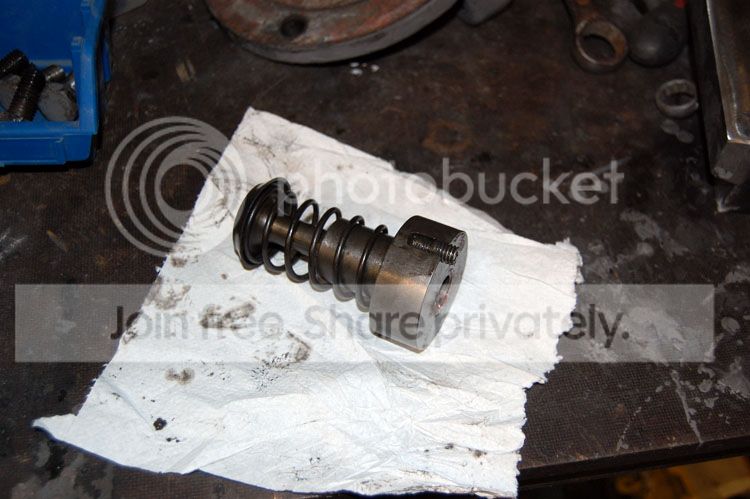

I cleaned and checked the "one way valve" today but did not find anything wrong with it...

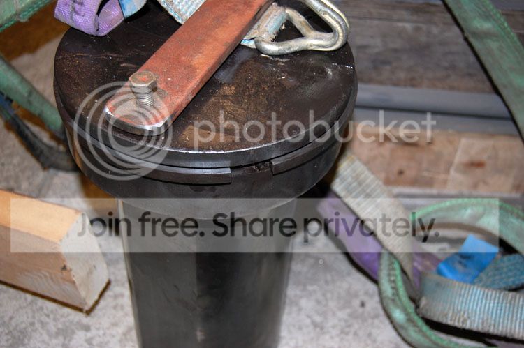

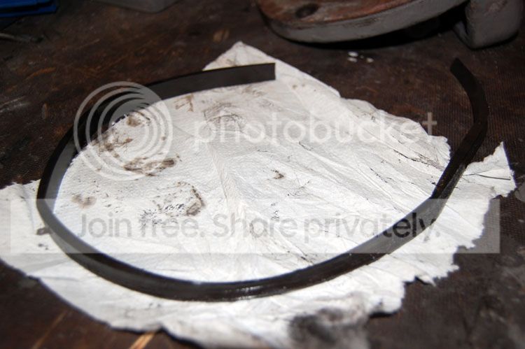

Today I pulled the ram and found a bad rubber seal. I also checked the guides but they seem to be okay as do the pistion ring. The ram had no play back and forth where the guides are, the play are sideways and is supposed to be taken care of with the rubber seal. The rubber seal was very worn in that direction.
This is the one way valve:
This is the ram and the pistion ring.
This is the rubber seal from the stuffing box.

Looks like with a new seal you are good to go.
