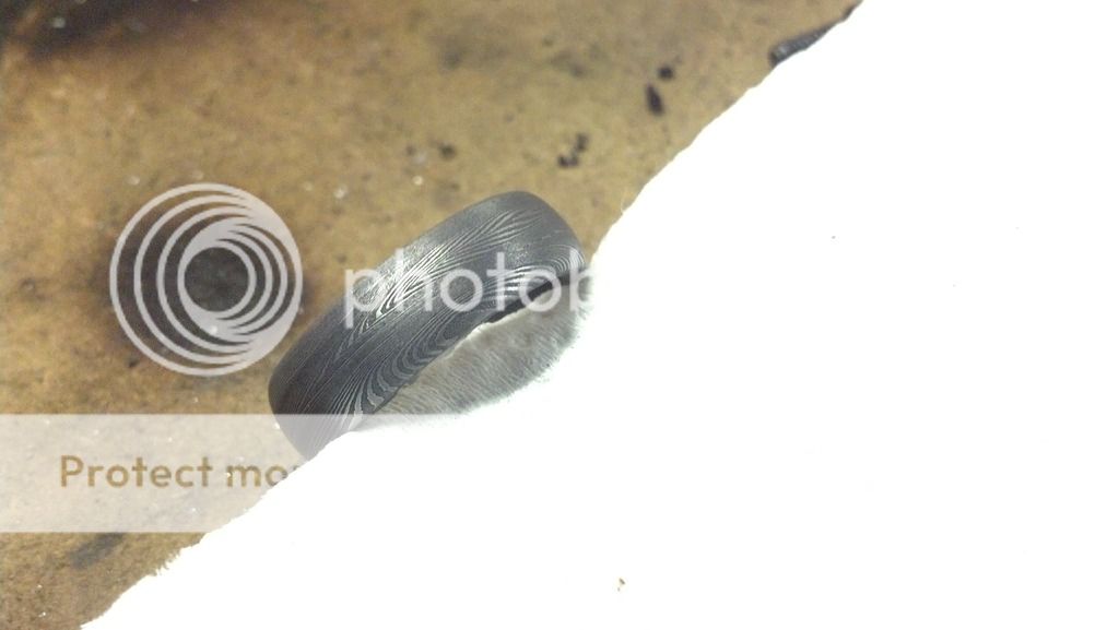

First let me say hello and introduce myself as this is my first post. I just started messing around with forging a few months ago and managed to make my first successful Damascus ring. I used 15N20, and O1 tool steel. The problem is the O1 will rust on the finger and make a yellow band (or the cold bluing that i tried to use).
I tried to experiment with 15N20 and 304 Stainless, but I couldn't get them to bond, and the 304 Stainless was even more resistant to the etching then the 15N20. Does anyone have a good suggestion to help the yellow band on the finger? A choice of steel that will etch, and wont rust?
Here is the ring:
(blued)
Stainless damascus seems like it would be a good choice in this instance. I can't help you with how to make it, but it could be a starting point for searches for you. You can also buy small quantities of stainless damascus if you are unable to make it on your own.

Our wedding bands are stainless damascus with sterling silver liners, made by a fellow named J. Arthur Loose. He uses 304L and 316L for the damascus. No problems at all with wear, corrosion or staining (either the rings or our fingers) after just over 3 years of wearing them constantly. :thumbup:

I'm pretty confident that jewelry containing low-alloy steels is going to rust/tarnish/stain your skin sooner or later (probably sooner) no matter how you etch it or coat it. Save the carbon steel for knife blades :)

It would seem that the 15N20 had less corrosion resistance then the actual 301/304 stainless.
Its encouraging because it means there will be a difference in the metals and thats all i want. I would have liked the black and silver, but maybe some cold bluing will help with that.
Now I just have to get them to bond. I am hoping leaving in the forge glowing at the max my forge can do, and squashed by my 50 ton press will be enough to bond it.
