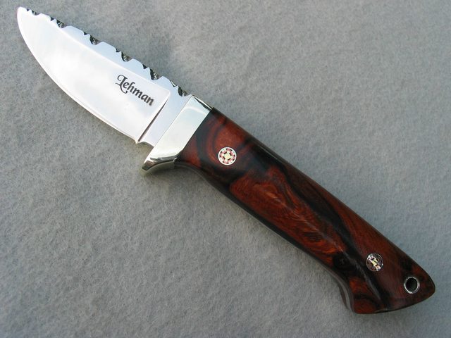

I am getting a little frustrated and need some help. I keep getting some blotchy smudge looking marks around my makers mark. If you look down and to the left you can see what I'm talking about. You have to hold it in the light at the right angle to see it. This is Cpm154. I am using etching solution from trugrit and an atlas mini etcher. I upgraded the q-tips to a Lectroetch pad. I'm guessing it's bleeding through or something. I'm also using masking tape. Maybe a different tape?

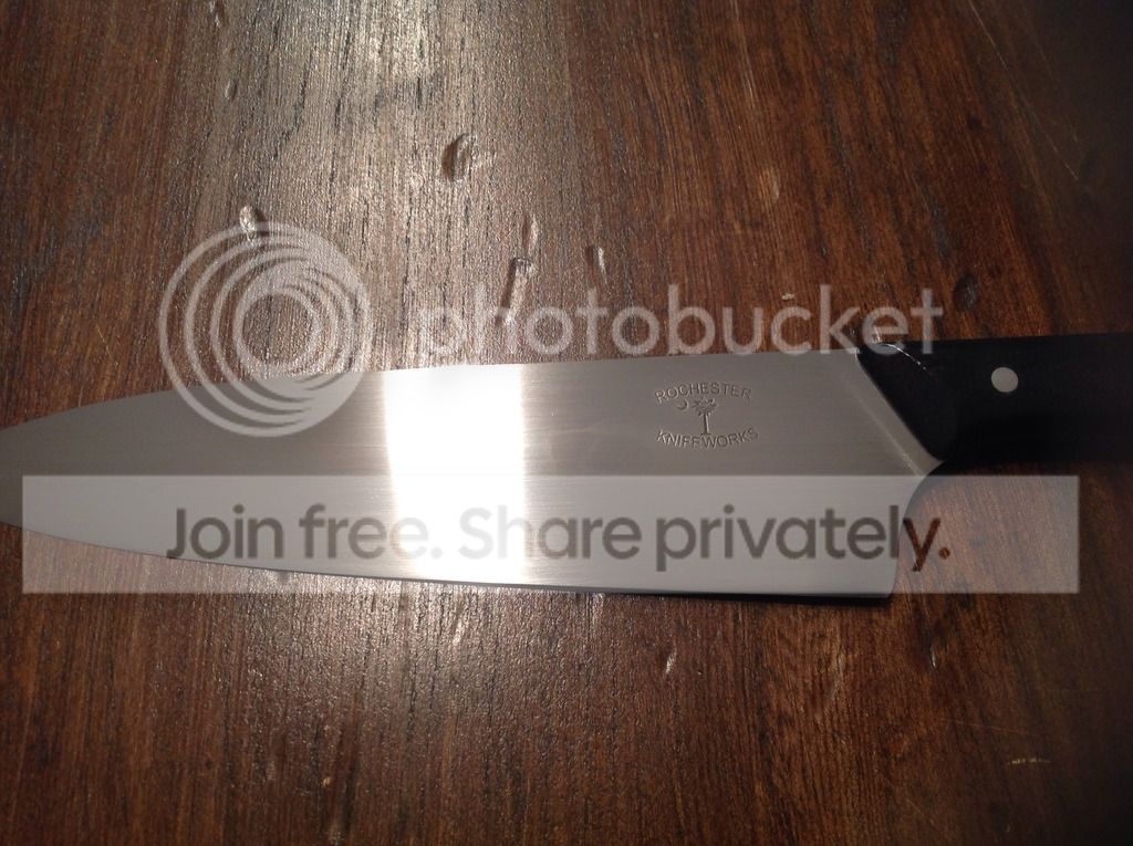

It's not a haze around the mark. Look to the bottom left of the mark and you can see what I'm talking about.
What was over the area in question when you etched it, tape, stencil? What ever was there is your culprit.
