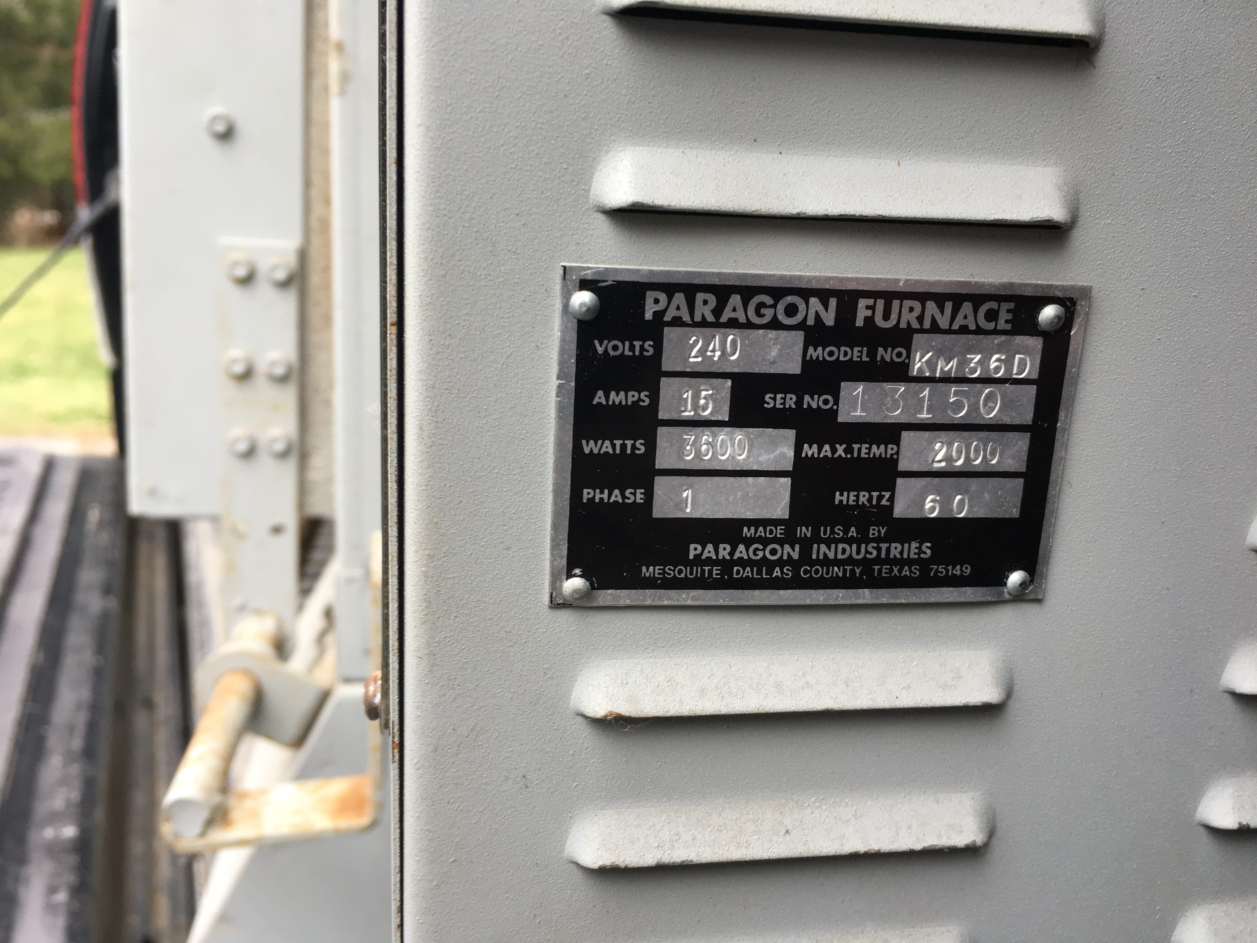

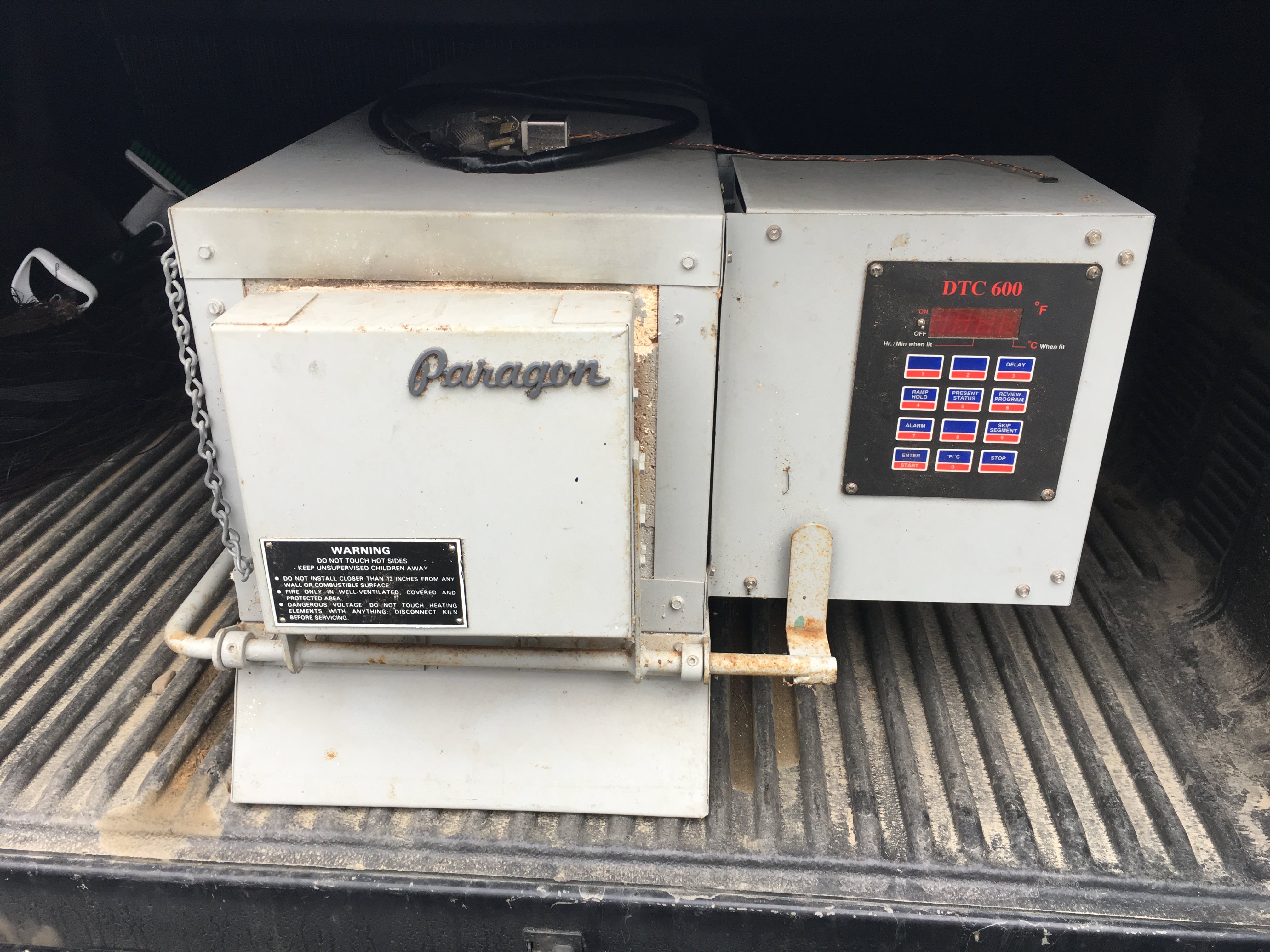

I just bought a kiln off a friend. Did I screw up!!!? I have a free return policy if I don’t like it. It’s a Paragon KM36D with DTC 600 controller serial number 13150. Looks like an older kiln and is wired for 240v. I need to wire power for it and test it but I want to know if this is a decent kiln? I paid $500 is it too much if it works?
I know a lot of knifemakers who would love to have that kiln. 36" is great for swords. $500 is crazy cheap.
Thanks! Hope it works, I might be getting it wired in this weekend! Is it still a good price even if it needs a new control or heating element? What do those run to replace?
Also right now I’m just doing knives, usually am around 10” overall max. Is 36”kiln a waste or a problem?
Good deal.
You can always change controls and elements
Since it's a brand named kiln, go to Paragon with your model number and you will get the proper elements that fit with no calculations or DIYing
re controls, Auber Instruments has lots of control options for a hundred bucks ish, maybe two hundred max if you do new relays/solid state
Still a great deal. Elements are basically considered a consumable. Though they can last for years (depending on use, too, of course), things happen, and they will eventually need replaced. If you download the wiring diagram for your kiln on Paragon's website, it gives you a part number. Looks like replacement elements for that kiln are around $120, which isn't terrible.
As for the controller, those can last for decades without ever needing replaced. If it does crap out, I'm sure Paragon would sell you a new one, though you could get any number of controllers to work for it. Evenheat makes a nice touch screen controller that coud probably be adapted to this kiln pretty easily. As count said, Auberins sells some quality PIDs for good prices as well. You'd probably have to modify the front mounting plate, but most PIDs should wire in just about the same, as long as the input voltage range is OK.
What may burn out before the controller, however, are the switching relays for the element, or possibly the control transformer. These are relatively cheap, and commonly avaible from any number of suppliers.
At any rate, if it wires up and works now, you may be good to go for years and years... If this is something you rely on for income, it's still not a bad idea to have an extra element or two on hand, along with things like fuses, a relay or two, and even a transformer. A spare controller would be a low priority as far as I'm concerned, but you could always have a spare to adapt to something like a salt pot, tempering oven, or who knows what.
If the kiln is older and has been use a good bit, I would put in a new TC for general principles. They cost about$20.
Thanks for the replies. Just fired this kiln up and it took a little over an hour to reach 1950. Is that abnormally slow or is it because of the depth 36”??
What a coincidence, there is another person on here that also has one of these and he said his takes the same amount of time to heat as yours.
