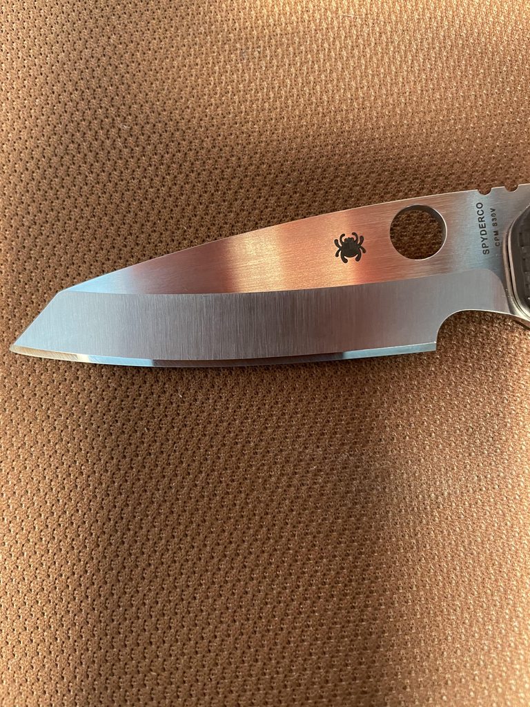

I’m sharpening with a Hapstone M3 and I’ve noticed that my blades are losing the normal curvature after sharpening. There are some problem areas on a blade that doesn’t come to an apex as easy as others and I’m thinking the problems is push pull stroke. Can anyone help me correct this from happening. I practically turned my dragonfly 2 into a wharncliffe and not on purpose.

Yes that does make sense and thanks for the photo. That is exactly the kind issue I’m having. Won’t focusing in on one area enlarge the secondary bevel or change the edge line? I’m finding it takes quite a bit of work to correct a small area illustrated in your photo.

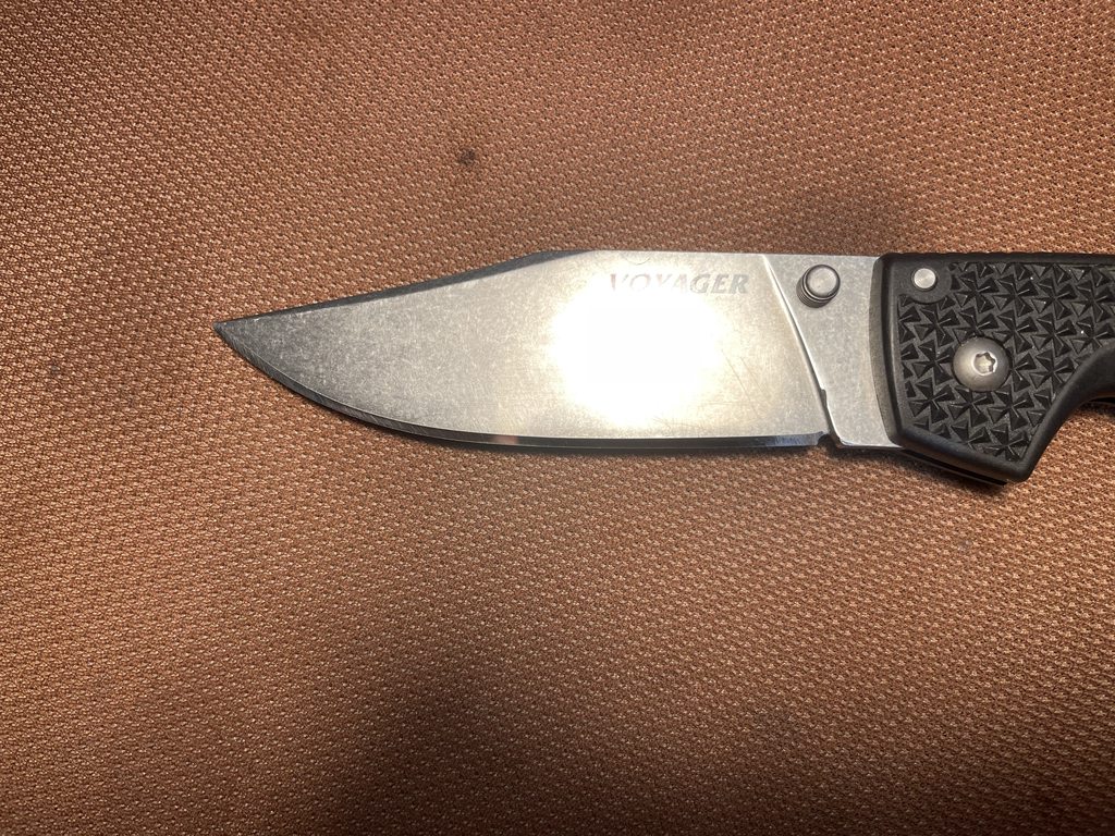

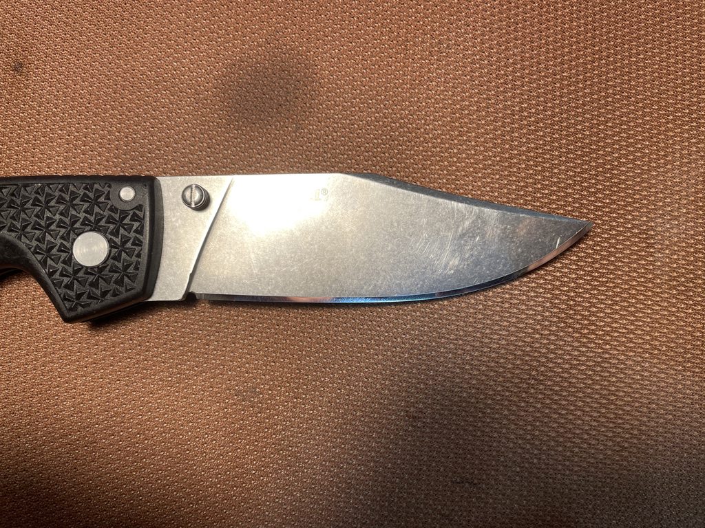

Okay, I spent 3 hours sharpening one knife tonight and I’m just frustrated. It was a factory edge spyderco. I used sharpie to confirm the angle was at 15 degrees. One side the heel and the tip were way off from the belly of the blade. It took an hour or more maybe to get it to where I thought it was perfect. The tip gave me the hardest time. I was using a CKTG 140 grit diamond plate. I started with a Venev 240, but that would have taken to long. One side ended up with a larger bevel than the other. When progressing up through the grits the tip didn’t get sharp and the heel is hazy compared to the belly. I have the run the length of the edge with every stroke because if i just focus on the heel and tip the blade gets missshapened and not longer looks factory, which happened again. Why can’t I get the heel and tip. I’ve sharpened a knife every night this week. Same problem. I feel like to do it right I would take off WAY to much metal.

1. You need to make sure that the edge is receipt paper cutting sharp at each stone, even from the coarsest, from the tip to heel after deburring on the stone as much as possible using very very light strokes.
2. Also make sure that your stones hit the blade at the same angle using an angle cube. Some stones may be thinner or thicker than the others. Then, you may not hit the apex at every stone. I can kind of see that finer stones might not have reached the apex on Coldsteel.
3. For the Coldsteel, you hit the ricasso and therefore raise the stone there. This may make the heel area unreachable for some stones. Try adjusting the blade position on the stage to see if it helps.
4. If you rounded the tip, you might have slid the stone too far off from the tip. Stop the stone when the tip reaches the midline of the stone.
Finally, do not sharpen your fav knives until you are sure about the system.
I have ruined good knives at the beginning myself.
Just use cheap knives for practice.
Edit: When you do the Sharpie test, you should use a fine stone like #600. Coarse stone may be able to scratch the Sharpie near the apex even at a shallower angle than the true angle.

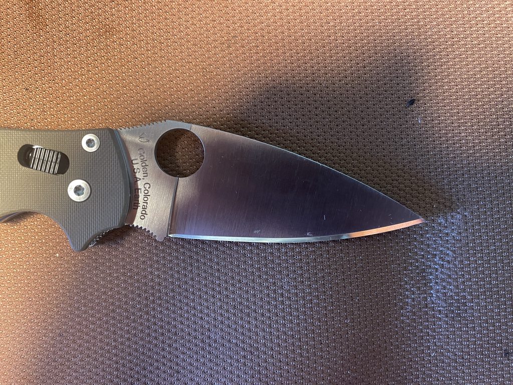

Since Spyderco knives do not have a sharpening choil, you cannot sharpen the very end toward the heel.
You should either stop the stone before its hitting the ricasso thereby putting the stone on the bump (see the pic), or remove some materials off first from the heel area using a corner of a coarse stone.
It needs some patience, and the result won't look very nice because you may need to remove some materials from ricasso as well.

If you want to have the very heel sharpened on Spyderco, you can use your #140 and grind off materials from the bump first.
If you don't care about it, then you can start from Venev #240 and raise a full length burr from the tip to the heel (or before the bump).
Since you have already reprofiled the edge, you won't remove so much materials off.
The tip may need some work, but it shouldn't take longer than 5 min on each side.

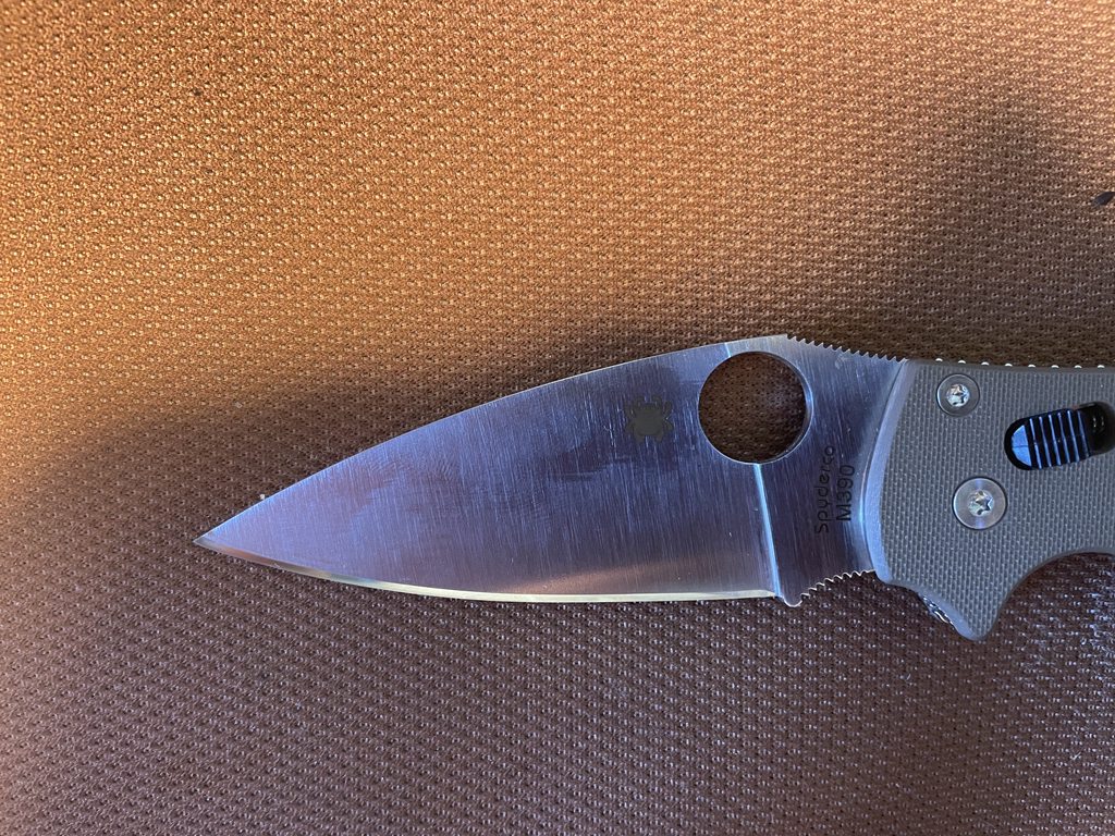

I might try and go back on the Manix with a 240 grit Venev and work on the heel and tip. Yeah I notice the higher I go in grit the more problems present themselves. I might try and stop at the 400 Venev stone. Here is the Smock I worked on last night. I think this one should be salvageable. Again the tip was the problem with this one and the heel looked good in the lower grits, but as I went up in grit there is some haze at the heel in the light. With the Smock and the Manix would you go back to a 240 venev and raise a burr heel to tip? And are clamped systems better (easier) than the M3 I have?

To me, both Spyderco look pretty good.
If they are sharp from heel to tip, I would just use them until they demand resharpening.

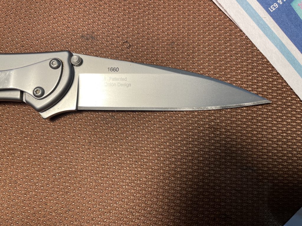

Thank you Miso. I feel like it’s starting to come together. I sharpened a kershaw leek tonight. raised a burr heel to tip at each grit, deburred before moving up in grit, checked angle with angle cube with each stone change. Stopped at Venev 400 grit. No stropping. It is pretty darn sharp and I’m satisfied with the sharpness. I don’t know if you can see in pics but it lost it’s wharncliff shape a bit towards the tip. How do I go about straightening the bevel line again and establishing the wharncliff shape? Do I remove move metal at the heel? Or remove more metal where the curve is developing?
That would be quite difficult.
I have never done this, but you should probably grind the edge by putting the blade perpendicular to a stone to make the edge line what you like.
Then grind the edge bevel to reform the apex while keeping the edge line, which requires grinding specific spots more than the others.
Or, you can gradually correct it by grinding more from the belly over many sharpening sessions.
I think in the future you should start with the factory angle at 18~21 DPS but not 15 DPS.
A jump from a factory angle to 15 DPS requires a lot of effort, time, and substantial loss of metal.
