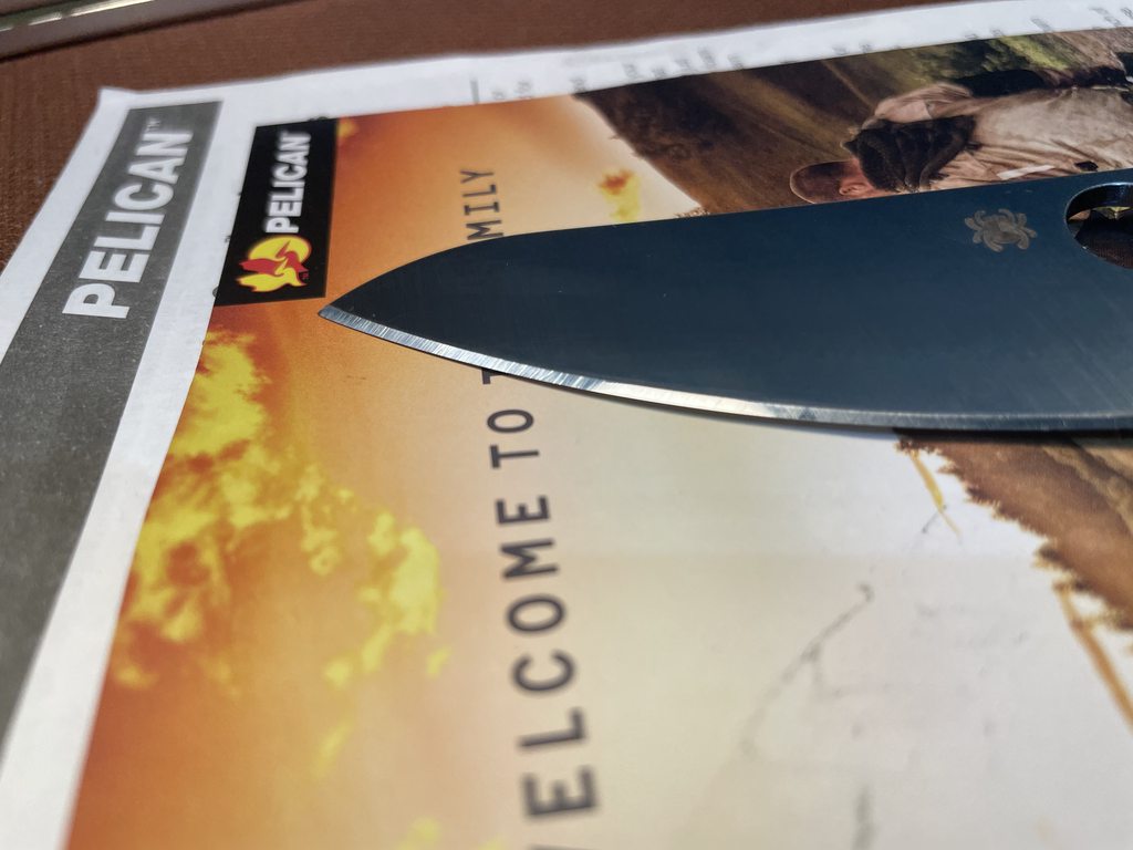

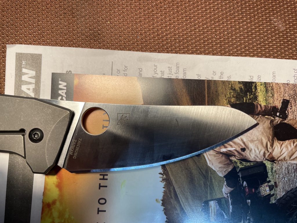

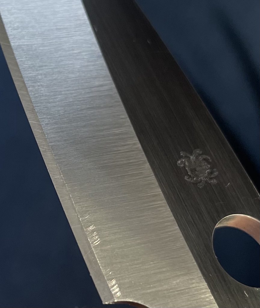

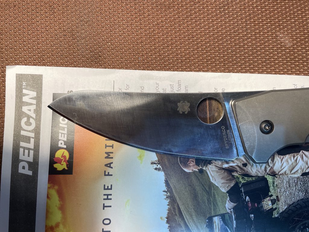

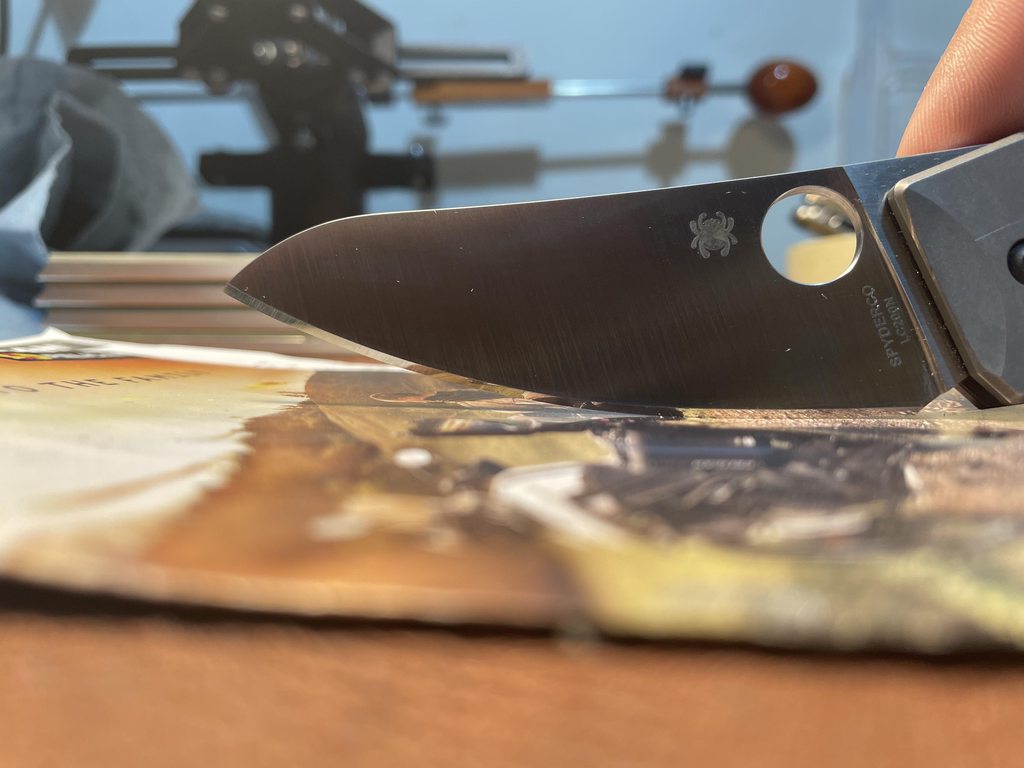

I have the matrix stones too, but it seems right at the edge there are faint scratches that seem to come from the stone. Do you tape all the way right up to the edge?
Like this?
Mine was due to a very coarse and friable abrasive.
Loose grits got in between the stone and the blade and made the scratches.
It doesn't happen often with diamond stones >#150.
I clean the stone, blade, and the stage often, though.
Yours looks a bit different from mine.
It looks more like the blade position changed downward at the spot.
That may occur if the blade is held on the stage at the flat area, or if the primary grind is convex or concave.

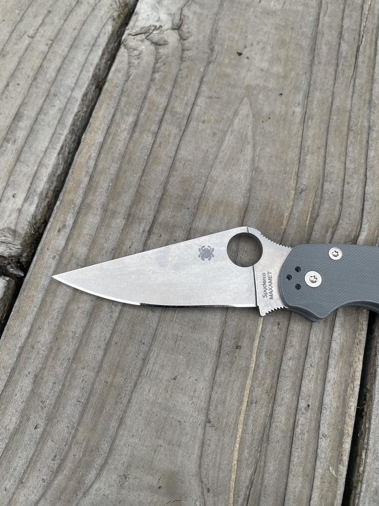

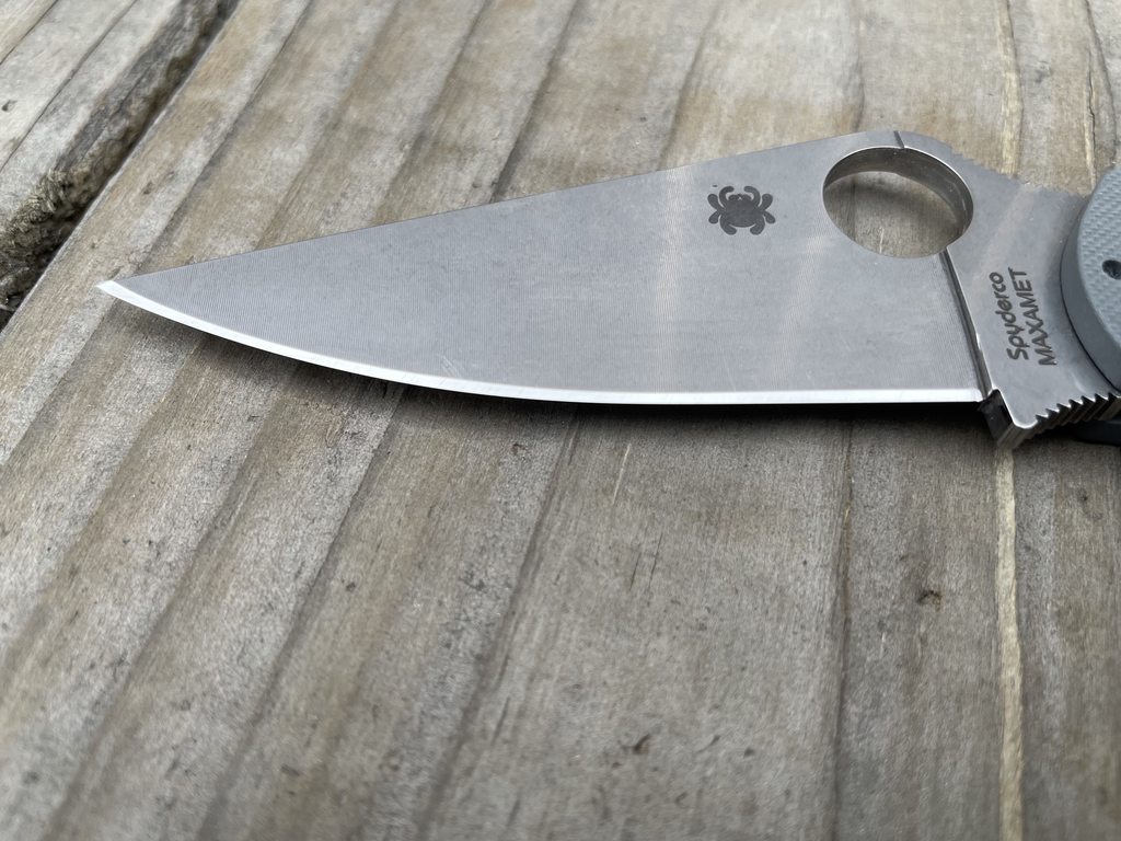

I feel like this is one of my better sharpenings. Got into the ricasso a little, need to work on that. But, I feel like drawing that imaginary line from tip to heel is yielding some of my better results. Used diamond matrix stones up to 2300 and then stropped 1 micron gunny juice, i know it’s a big jump, going to be ordering the 4000 and I have a spyderco ultra fine edge pro mounted on the way.
Sharpened my Spydiechef at 15dps. Set the bevel with my CKTG 140 and went up to Diamond Matrix 2300. I feel I’ve got the tip down pretty much. The heel at the plunge grind is still where I struggle. My stones hit into the shoulder of the scales. I thought about removing the scales tonight. Due to the shape of the blade I was concerned about bevel width from heel to tip if I lined up the plunge grind parallel to the stone. Any tips on sharpening the Spydiechef?

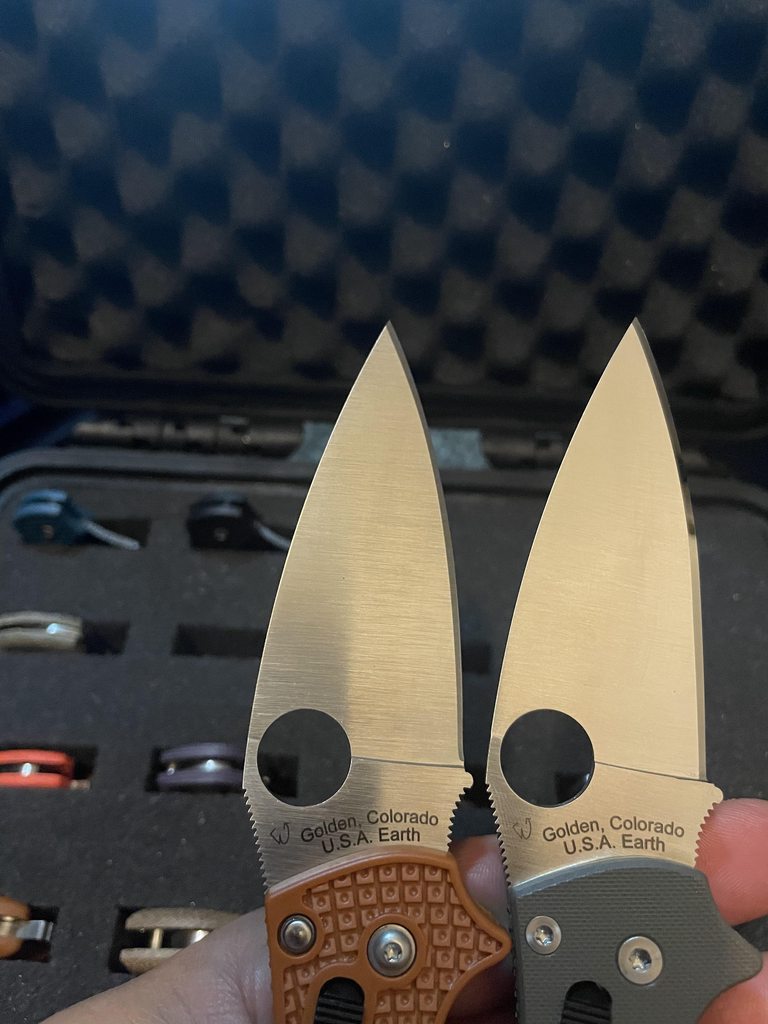

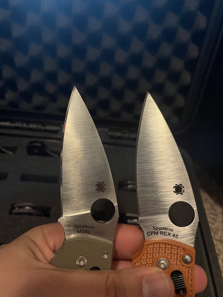

I got to looking at one of my Manix 2’s tonight and noticed one side looks different than a stock unsharpened Manix 2. It seems with factory angles sometimes significant steel needs to be removed to even out the edge and set each side at the same degrees. Is this normal? Is this excessive sharpening? I’m thinking of abandoning reprofiling to 15dps or 20dps, it seems it take a lot of steel removal sometimes and mostly on one side. As you can see in photos the M390 Manix looks different in second photo, more like factory versus the first photo. By the way I matched the factory angle to 17dps. This is after two full sharpening. Just looking to learn an hear what other’s experience has been, I really want to master sharpening. In measuring at the plunge it is about .043” shorter in height on the sharpened Manix 2, I have no idea if that is a ton or a little or average. You can see on the factory REX45 Manix that the factory edge is wider at the tip and belly and narrow as it goes back to the plunge.
