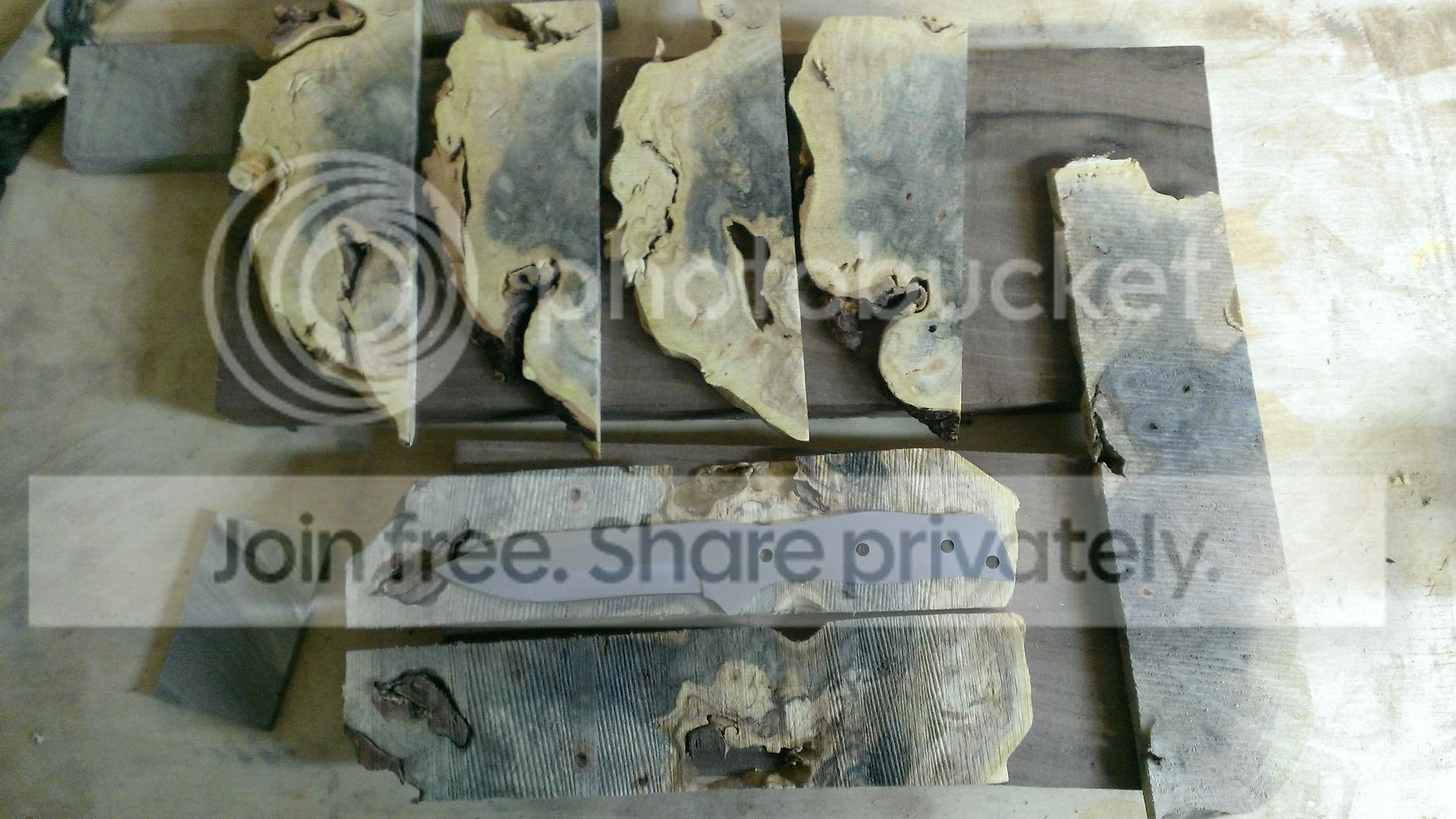

This was the selection process as I cut up the burl and discovered the usable scales.

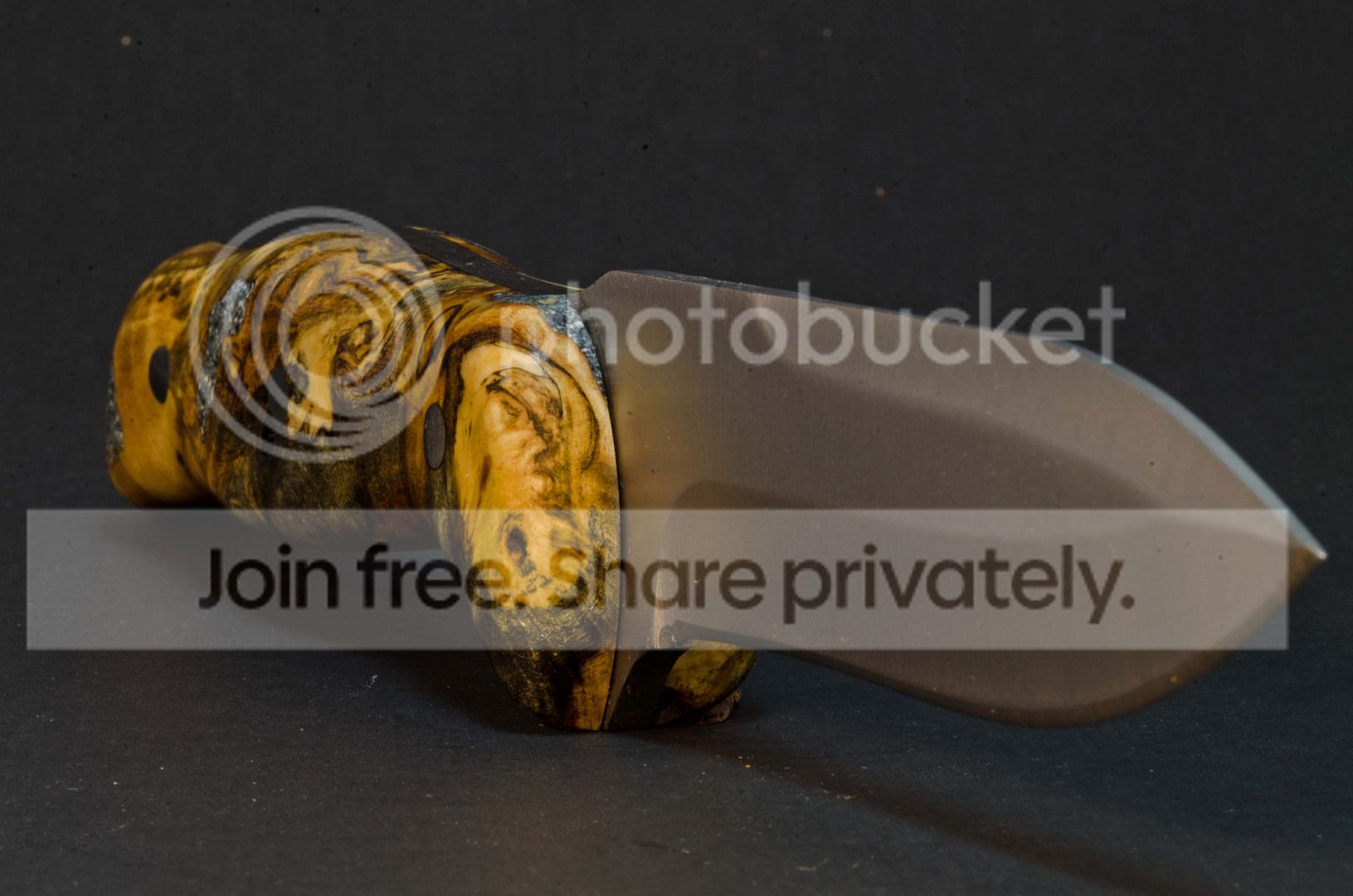

Also here is the knife I posted this question about.
That is crazy nice wood. The whole package really works.
