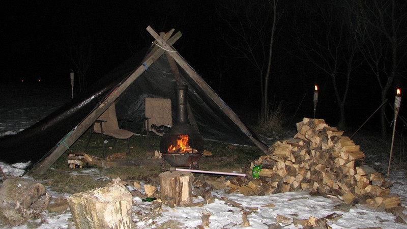

I need some of you creative Bushcrafters to offer up some advice.
I'm looking to redesign my Tarp set up. I am approaching a year and need a new tarp anyways. Looking for fall winter design ideas. Perhaps along the Whelen Lean-To Line, Semi-exposed sight,

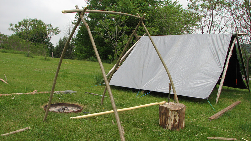

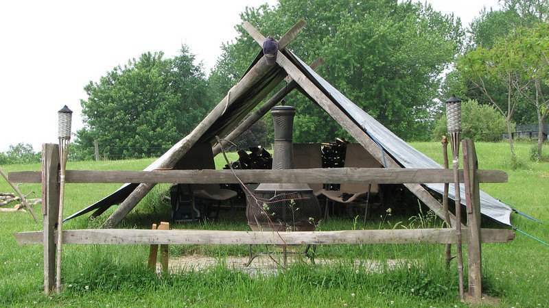

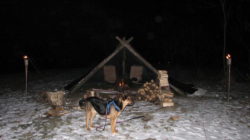

Last winter I had it set up as an A-frame front, with a ridge pole going from the front A-frame to the ground. I tucked in the rear corners and piled some snow around the rear section. For the summer I've had it set up as an open A-frame, for flow through ventilation.
My available materials consist of about 16-10' long split rails. My tarp from last year was 12'X20' I'm flexible on the tarp size as I need a new one anyways. I actually have been giving some thought to 3 smaller ones to achieve the Whelen style. I know; "Just Go Buy a Whelen" What fun would that be. I was actually amazed at how well the tarp has lasted. I think the key was the bungies allowing it to flex and shed wind.
My total cost for the year has been some para-cord, 20 Log Cabin spike nails for stakes, and $29.00 for the tarp on sale and about 10 bungie straps. Under $100.00. Not bad for 11 months of fun.
One Criteria; the bride needs some shelter from the wind and close proximity to fire when it gets below 30F. Since that's all she asks for I try my best to accommodate her.
So What you Got??
P.S. also have tons of Sumac trees for end boxing if necessary.
Summer set up;
Winter Version;
Yeah, it worked pretty well. But I'm looking for something different.
