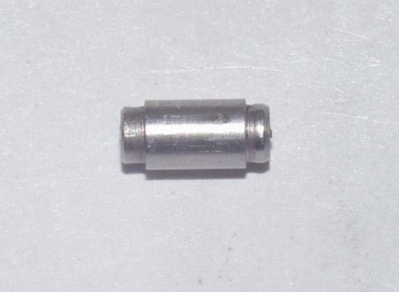

It's too late now, I guess, but just grind the tip of the drill flat. It will cut well enough for that little bit.
Machinists flat grind the tip of drills to get a square bottomed hole all the time. It won't cut as well as a drill, of course. So, what you do is drill the hole to depth with a regular drill and then use the flat bottomed drill to take out just the angle the drill tip made.

A small milling cutter in a drill press would give the best results if you want to countersink the pin into the frame/liner. They are not really meant to be used as a drill, but since the center area is already open and the amount of material to remove is small, a plunge cut would give nice square shoulders. Not too expensive, and you‘ll have it for future projects.

I just finished one borrow the blade stop pin from another knife and is PERFECT, no more ball bearings, smooth, good liner lock engage, no blade wiggle.

I am looking for the easiest way. I just need to find a shorter pin like this:
[/url
I don't know what this call. I need to find one that is 2.5mm at both ends, 3mm in the middle and 4mm spacing. If I can find that, I can just put it in and is done.
I found one in another knife, put it in IT'S PERFECT.
Well it might be tedious but I would try taking the edge of a piece of sandpaper and just sanding one side of the pin down a bit. It would cause one end of the pin to stick out past the liner a little bit, but you could sand that down too.
