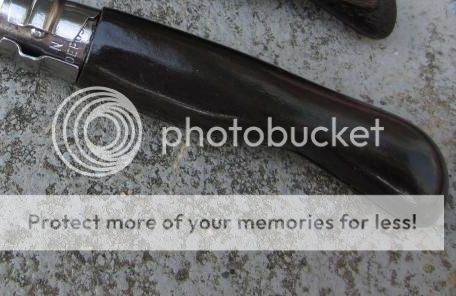

I have a No. 12 and love it. Mines carbon and I'm changing the handle but overall, love it.
