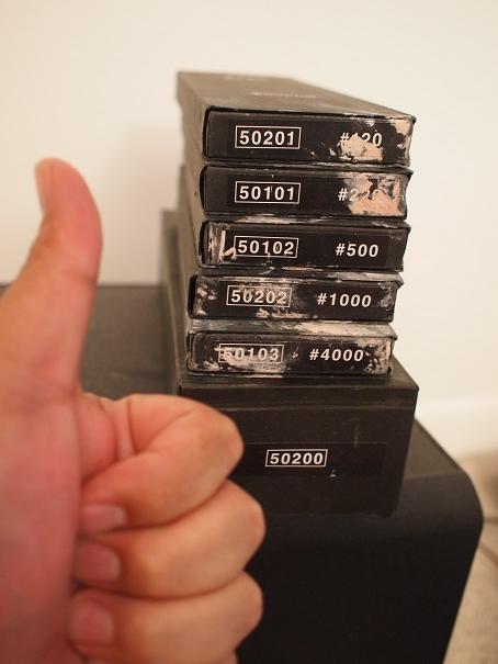

Shapton Glass Stones. A-OK!
The Shapton Pro's do better with carbon and low alloy steels, that's why they were not recommended.
The only Glass stones to be discontinued are the series for carbon steel. They are darker in color and I believe a Japanese market only item as of now.

Many people in this thread have recommended using diamond plates to sharpen steels with high carbide contents (particularly of vanadium or tungsten), or have recommended Shapton Glass Stones.
Instead of those recommendations, I would ask: If you like waterstones, why not just go ahead and get the waterstones actually designed to cut highly wear resistant steels quickly? Sigma Power Select II series stones are composed of silicon carbide abrasive and minimal binder, fused under heat and pressure, and as a result they are very muddy and cut faster than any other waterstone available on the market.
How quickly, you ask? Quickly enough to collapse the difference between 440C, VG-10, HAP40 (basically M4), and ZDP-189 and sharpen them all at essentially the same rate. Yes, they have to be flattened more frequently, but I just use my Atoma 140 to flatten the stones before each use, and the muddiness of the stones means that the stones tend to avoid forming much of a burr at any grit above 1,000.
Once i bought a few of these stone, I binned all the other stones I had as time wasters and none of my other waterstones have gotten any use since.
... My current favorite is the 400/1000 plate sold by CKTG, the grits are more representative of waterstones so the 400 cuts quickly and the 1000 yields a very sharp and toothy edge.
Just looked at the CKTG website and found that diamond combi stone. What a deal Jason, $35! Any experience comparing it to the DMT Duo sharp? That comes in a combi stone (blue 325/ green 1200) with a base for $125 in pretty much the same size.
The DMT is finer, the 400 is slightly coarser than the DMT Coarse and the 1000 side is closer to a DMT Fine but more toothy. It's really fast though and yields a very good edge, another great single stone option thats budget friendly.

We went through this once already, I have the sigma power select 2 1000, and the shapton glass 1000. The sigma doesn't cut noticeably faster and it wears waaay more rapidly. I bought the sigma as an experiment and wouldn't do it again. I will pay shipping for "all" the stones that you"binned" so they don't waste any more of your time with them.
Russ
Also, the sigma 2 are made of aluminum oxide, not silicon carbide...... Just FYI...
