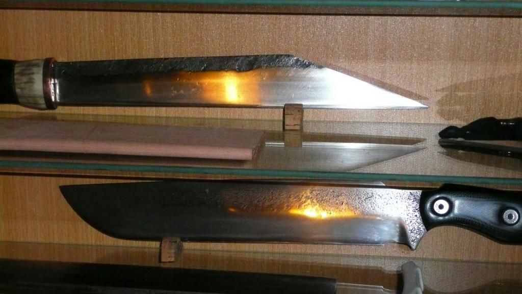

Hi guys. A good friend is having me make her husband a chef's knife for Father's Day. I had Buck Knives heat treat it. I made it out of 1095 that I ordered online but now I think they might have sent me damascus. When I went to Buck to pick it up (I live close to their factory) the guy said that he thinks it might be 1095 rain drop damascus because he has done regular 1095 before and has never seen it act like mine did.
It has a bunch of random spots all over the blade that look pretty awesome. I took it home and sanded off all the residue left on it from tempering. After sanding it still has a scratch around the edge of where each spot was. I've never worked with damascus before so I don't know if means its just a mistake or if it really is damascus. I'm really confused.
Has this ever happened to anyone else? Should I go ahead and acid etch it or should I sand it down all the way and act like it never happened? Even if it is not real damascus, would it still look cool if I acid etched it? I like the pattern of the scratches.

Edit: Whoops, too slow! I've never seen anything like that before. I've seen some strange bubble effects from different quenchants and funny shenanigans with heat treatment, but nothing like that.
It's not raindrop damascus, anyway. There may have been some kind of contamination of the blade before HT, or they may have forgot to degrease the blade before applying anti-scaling compound. The patterning suggests one of those "oil and water don't mix" effects. If you sand it back and then etch and the pattern returns, the pattern is in the steel. Cool effect, though.

Edit: Too slow again. The pattern definitely looks like oil on water emulsion effects. Maybe an interupted quench from oil into water?

If it were me, I'd leave it alone. The effect is very cool, kind of "Martian Amoeba". If they did this pattern in damascus, I'd buy a couple of billets. This is not that much different to "forced patina" effects and retards attack by corrosion as well as adding visual interest. I''d maybe dip it in "kurust" or "rust remedy", though, to convert the red, because red rust is bad , black rust is good.

I would suggest you sand down to bare shiny metal, and then etch. I would etch it in 3:1 ferric chloride, but if you use HCl, please dilute it a lot.

looks like it was overheated and the surface started to go into solution in a non oxidizing (inert) atmosphere so the carbon didn't burn like it normally would. I would like to see a micrograph of that if the knife ever breaks. My guess is that your grain structure is a little on the coarse side.

It does look really awesome. Does it go into the tang too? If so, take the tang to a 600 grit and see what happens to the pattern. Does it disappear and more importantly, can you bring it back with an etch? Would hate to see you loose the effect but the blade still doesn't look quite finished yet.
