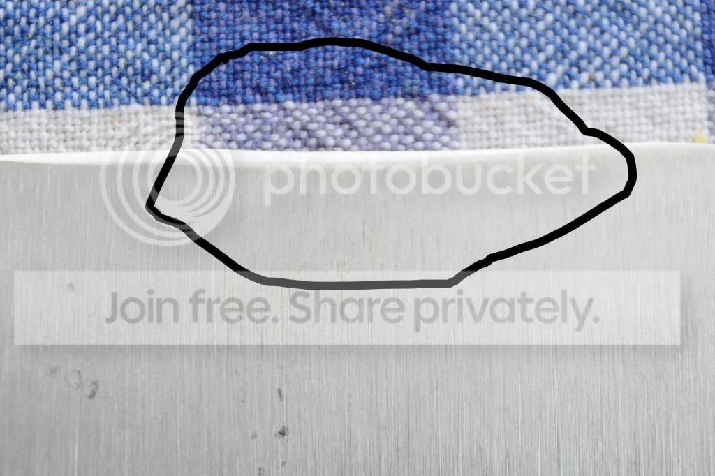

I want ask you guys for a little advice on grinding kitchen knife bevels to zero or near zero.
My quest to make awesome kitchen knives has been hitting road bumps. What ends up happening is I get a low point along the edge. If I sand or grind the edge on the higher points on either side of the low point, to even it back out, then continue working on the bevel I end up making it worse. The steel at the high points is obviously thicker, so when I try to thin/even it all back out along the edge I end up also thinning what was the low point, only now it's lower.
I've been doing about half of the grinding post heat treat to avoid warping in the long thin steel.
Below is a sample pic. I'd like to say I was testing my heat treat to destruction, but alas, I lost my temper and took a hammer to it :mad:. Anyway, I've over exaggerated this sample, on the grinder, to demonstrate what I'm talking about.
I'm pretty sure this is happening because I need more practice holding the blade steady and even. That being said, how would you guys go about fixing a zero bevel with low spots along the edge?

Is that mark 2 inches from the plunge? It could be where you focused on one area and got a 2 inch mark at the other end of the belt. I get the same stuff sometimes. If it's bad enough have some fun with it and abuse it before you scrap it.
Maybe try to be aware of the full belt width on the grinder, keep the sparks in the middle of the belt.
Also, make sure you check your platen. Naturally, any sort of deviation from dead flat is going to give you problems. The platen on my cheapo griner had a low spot in the center, and I had to flatten it in order to get decent results.
I agree with Daniel about Culinary knives being a real chore and If I am understanding the question correctly, the way I would fix the dips in the edge of the blade is to re grind it flat by starting at the heel with the edge pointing up at me and bring the blade towards me to the tip.

I'm actually not sure were this particular section was from. I picked up of from the pieces of my "destruction test" and took it to the grinder so I could show a visual. The problem area on the knife before destruction was about an inch away from the plunge, toward the blade.
Thanks for the tip though, it makes me re-look at how I'm holding the blade while I grind and now that I thing about it I believe that I'm over compensating, in trying not over grind at the two inch mark and putting the steel to the belt prematurely on the plunge side.

That is often referred to as an over grind and is very tough to deal with on a kitchen knife, as it will leave a hole in the edge where it wont contact the board. I check and recheck the edge on a granite surface plate to catch these early and fix them. Grinding to thicker steel, thus reducing the height of the knife is the only fix I know of. The trick is to catch it early and fix when it is small. Canting the blade in relationship to the platen reduces the amount of belt in contact with the knife and increases stock removal rates. As you get close to your final thickness, only grind with the blade square to the platen to reduce this from happening. Good luck .
